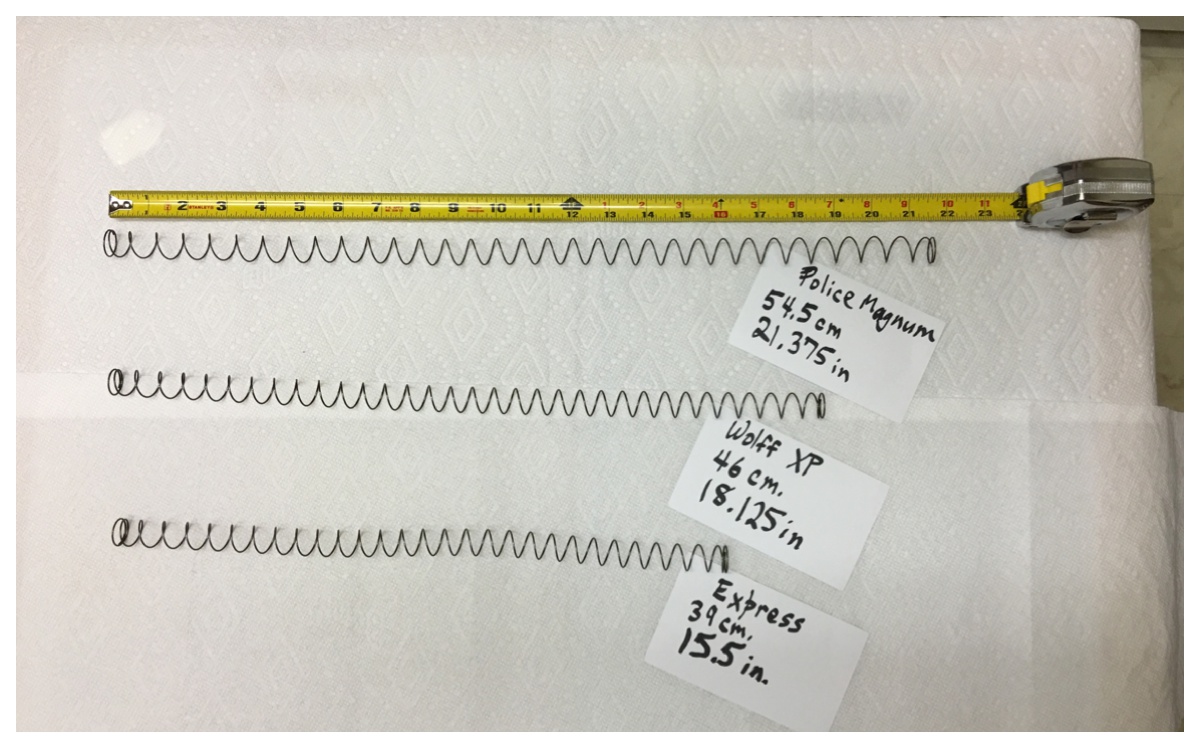

I was swapping out the magazine follower in an almost-new Police Magnum 870 this morning and, due to the frequency of the topic, started wondering: How long are the various magazine springs and how much pressure do they exert? The discussions I've read never seem to quantify these, so my curiosity got the better of me. I had to find out.
Since I had the almost-new Police Magnum opened up, I grabbed its spring, one from a swap-out on a new Express, and a new Wolff XP spring I'd ordered from Brownell's. Since these were all three essentially new springs for a 4 shell magazine tube, the comparison should be "apples to apples."
First I measured the lengths. Here's a photo of the results:

1. The Express spring is definitely a bit "weaker" than the Wolff or Police Magnum spring, so if a "stronger" magazine spring is desirable, the upgrade to an aftermarket or Remington Police spring is probably worthwhile.
2. The longer spring is not necessarily the "strongest" spring. The slightly shorter Wolff spring caught up with and surpassed the Police spring above the "two shells" level.
3. It is darn hard to measure spring tension accurately without some more specialized setup. If I can figure out a way to set it up without risking breakage of the food scale, I think some sort of horizontal or "top down" positioning would yield a more accurate result since that would take the weight of the gun out of the equation altogether. Hmmmmmm.
4. For the stock Express spring and aftermarket Wolff spring, each shell seemed to have added about 16 ounces of tension. I was surprised at this, it doesn't "feel" like that much when doing an actual magazine load.
5. For the most consistent "feel" throughout the entire compression cycle, the Police spring seems to be the winner. I'm not certain if that's a desirable trait or not, but there ya go. It might be that a linear proportional increase in tension per shell is more desirable from the reliability standpoint. You pay your own money and make your own choice.
