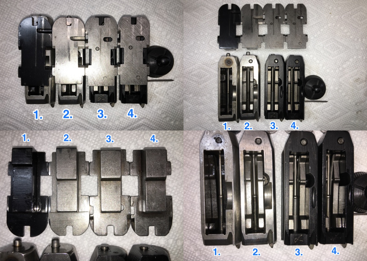

I found that the various 870s that I have access to cover a surprising number of variations in these parts and so I have prepared a series of photos to document what I observed.
To get things started, here are some side-by-side photos of the variations I have noted.
Bolt / carrier #1 is from an old well preserved Wingmaster that had a 28" fixed choke (modified) ribbed barrel.
Bolt / carrier #2 is from an _old_ 870 that appears to have been used by an LE organization. It is a Wingmaster, not a Police model, however.
Bolt / carrier #3 is from a recent Police Magnum model which apparently came with the flex-tab conversion.
Bolt / carrier #4 is from a new (2015) 870 Express, added for comparison, a "flex-tab conversion baseline".
So, to summarize, the first two examples are pre- flexi-tab, and the last two are recent that have the flexi-tab setup.
I will post additional comments in this thread to contain close-ups of the parts in question.
I also found at least one other variation but do not have pictures taken yet.
If you have information regarding when Remington transitioned from one of these versions to the next, please share it here with everyone.

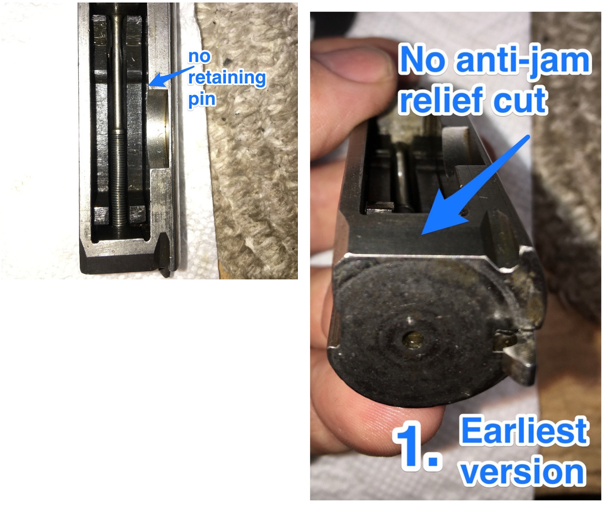

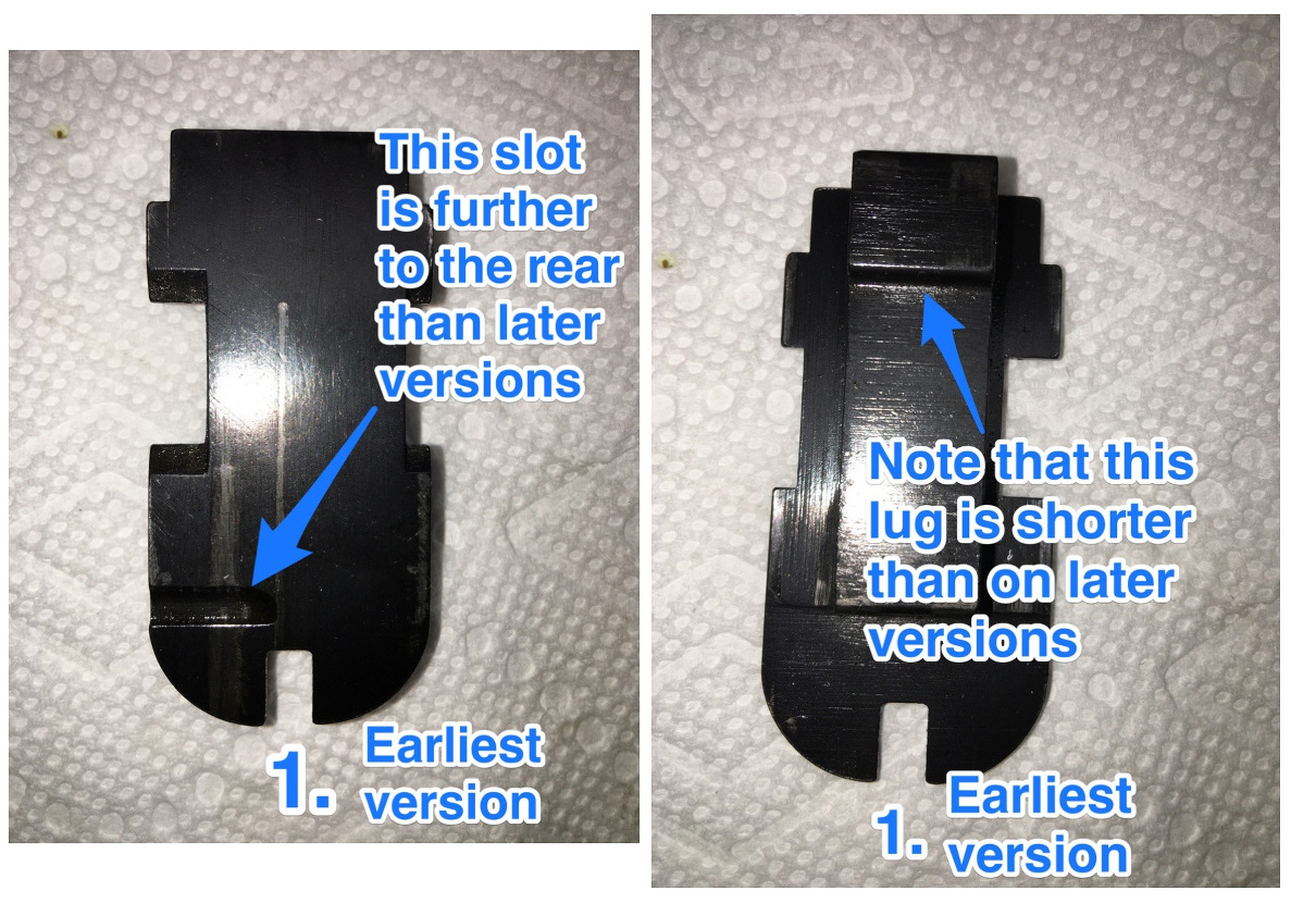

Details on bolt / assembly #1. This is the "oldest" version of the breech bolt and carrier assembly that I have come across. There may be versions which precede these but I've not seen any. I have access to a couple of 870s (including the one from which these are in) that date back to the 1950s. If anyone has more information on these, please let us know!
UPDATE # 1
I've found a bit more of information about the technical jargon surrounding the breech bolt & slide assembly in The Remington M870 and M1100/M11-87: A Shop Manual, by Jerry Kuhnhausen, 1992 edition, still available through Brownell's. From this point forward, I will just refer to the book as "Kuhnhausen" and give the page number from the 1992 edition where I found the information.
So, Kuhnhausen (page 70), reveals that the "slot" on the bottom of the slide assembly (he calls it the slide block) is called the "carrier dog cycling slot." Its placement and level of wear and tear affects the timing of the shell carrier rising. Mystery number 1 solved.
On the same page, Kuhnhausen also reveals that what I have labeled as a "lug" on the top side of the slide assembly (aka slide block) is called the "locking cam".

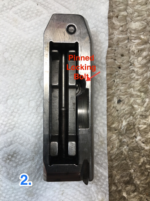

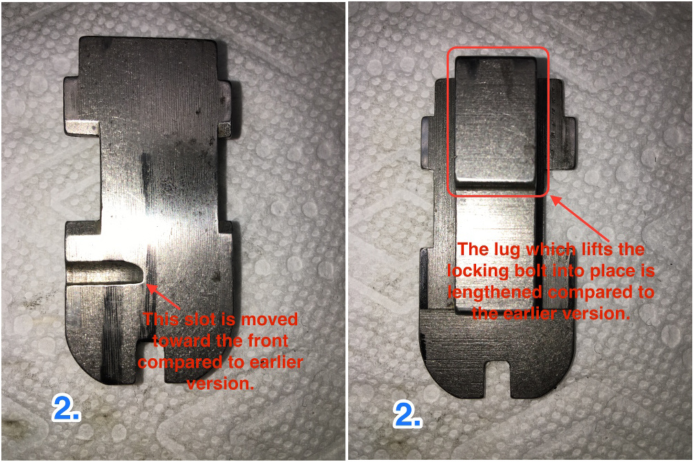

This second example breech bolt and slide assembly are from a heavily used but well cared for Wingmaster 870 that dates back to sometime (probably) between the mid-sixties to mid-seventies.
The most noticeable change to the breech bolt is the addition of a cut-out and pinning mechanism for the locking bolt. The locking bolt will no longer drop free when the breech bolt and slide assembly are removed from the receiver.
Changes to the slide assembly are the elongation of the locking bolt lift lug (the proper name for this lug is "locking cam") and the movement of the slot on the bottom further toward the front of the assembly away from the tail. By the way, can anyone chime in and help us figure out what the function of this slot is? (UPDATE: Never mind. It's called the "carrier dog cycling slot" and its name accurately describes its function.)

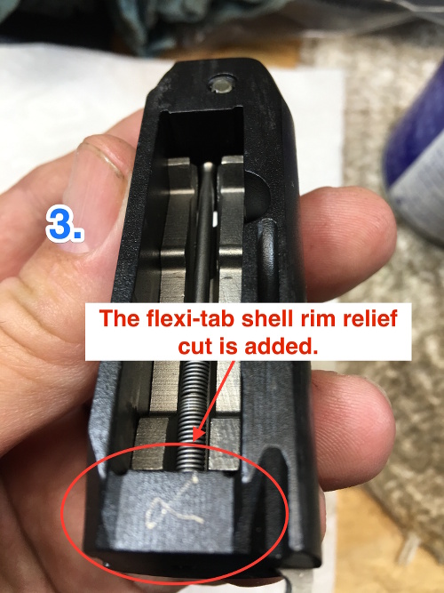

Re: Evolution of the 870 breech bolt and slide assembly

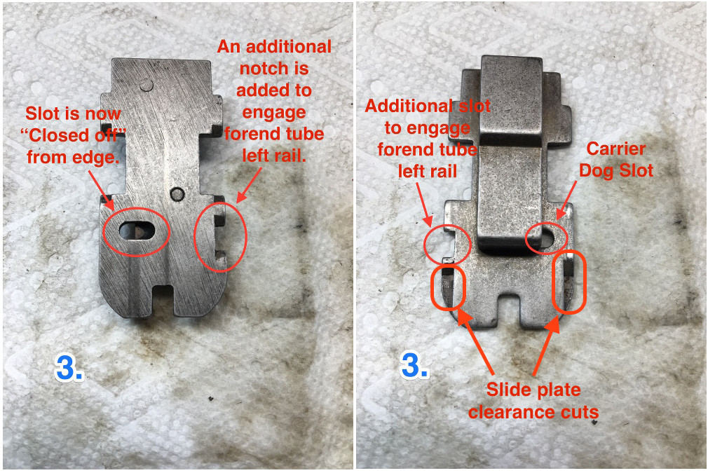

As promised, here are the annotated pictures of the flexi-tab version of the 870 breech bolt and slide assembly.
First, the breech bolt: Now the slide assembly: I think that the annotations are fairly self-explanatory, but here are my additional observations:
1) The carrier dog follower slot is now "closed off" from the edge of the slide assembly, but also extends completely through the base of the assembly, creating a "peek-a-boo" hole! I suspect that this was done to enhance the strength of the assembly. The Kuhnhausen shop manual instructs gunsmiths to inspect this area for stress cracks and to replace the slide assembly if any are found.
2) The additional notch to engage the left carrier rail of the forend tube is interesting. Its presence does not preclude the usage of the flexi-tab breech bolt and slide assembly in combination with an older pre- flexi-tab forend tube assembly. However, if you must replace your old forend tube assembly with a new one, you will have to either replace your older slide assembly or grind off the engagement lug on the left rail of the new forend tube assembly.
I am not going to post any detailed pictures for the Express breech bolt / slide assembly (#4 in the original "top" post) because it is identical to the Police Magnum pictures in this posting.
I will wrap up with some additional observations and pictures in the next post.
