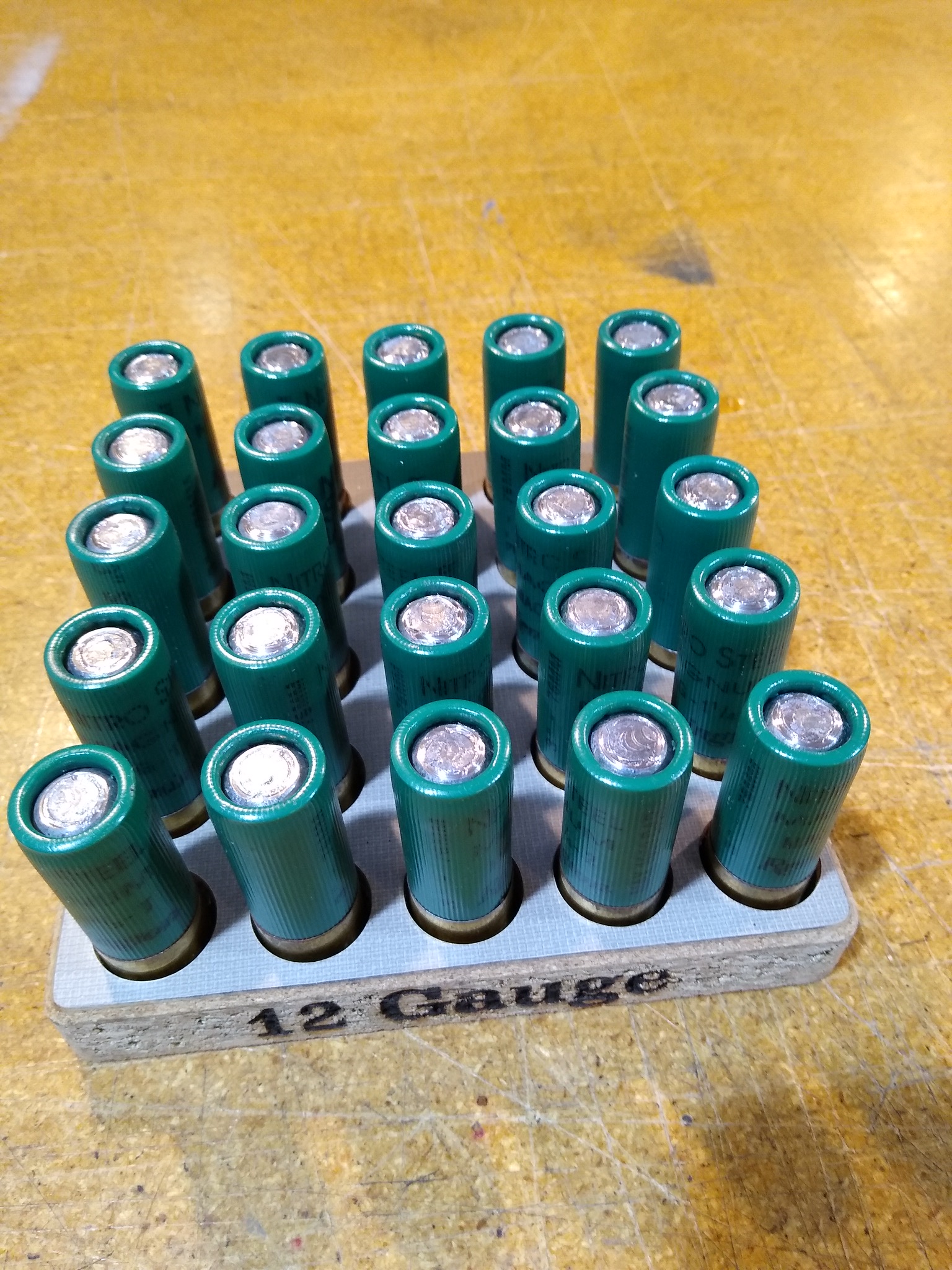

If you haven't tried roll crimping, do it. I do it on all my buckshot loads now and my TSS turkey loads and did it on some slugs I molded and reloaded.
- slug.jpeg (792.07 KiB) Viewed 13260 times
