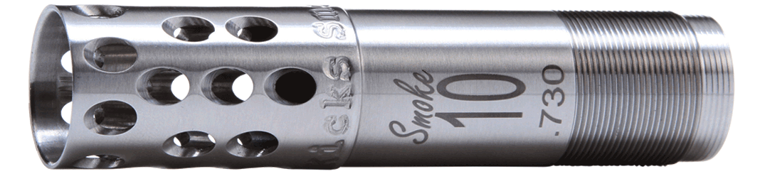

    The picture is a 12-ga but the 20-ga looks the same, ID = 0.610.    This is a “Smoke” model, their HighFlyer looks the same except BLACK.  Both come in four or five different Choke Sizes.

    Remington Pro-Bore chokes are only made for special over-bored 12ga barrels. Remingtons with standard 12ga bores or any other gauge use Rem Chokes (some older shotguns differ, but that doesn't apply to 870s).
    20ga Tru-Choke and Rem Choke tubes are not interchangeable, they have different threads (this link gives some info on that). I don't know why you were told that you would need to go with Tru-Chokes. You certainly could if you wanted to, but if you want to stick to the factory standards (a smart move for resale value, if nothing else), you should have your barrel threaded for Rem Chokes. Sometimes a barrel can't be threaded for a specific choke tube system because it doesn't have enough wall thickness, but that shouldn't be the case with an 870 barrel. Your gunsmith might be trying to sell you on Tru-Chokes because that's the tooling they have on hand.
