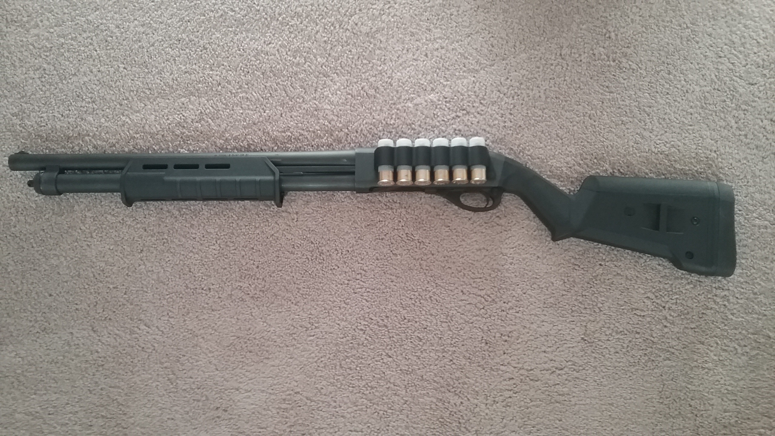

Here's my "Plain Jane" Express Magnum Synthetic.
I did make a few mods because I wanted something that my wife could use for HD (I have an 870P) and that I could use for sporting clays. It came with a factory 2+ extension but I took it off and sold it (I know, don't hate me) and bought an extra Remington 26" vent rib barrel for the clays. While it's in the house it wears the original 18" barrel. I also swapped out the original "J" lock trigger for a standard composite one and added a Wilson Combat jumbo safety. Instead of a side saddle I opted for an Uncle Mike's neoprene shell carrier so I can keep some rounds handy inside and then empty it and not look TactiCool while shooting clays.

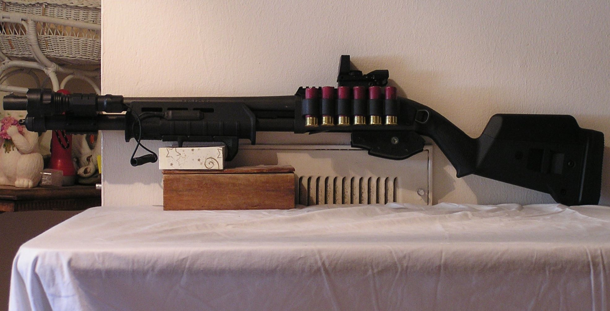

Magpul Butt stock w/ cheek riser and Forend , 500 lumen light with pressure switch, Trinity force reflex sight,combination side saddle with rail replaced factory extractor with a NON-MIM extractor added a Magul front sling mount (not shown). Think I am done any suggestions?
- 001 (5).JPG (253.44 KiB) Viewed 21566 times
- TexasArmor84
- Senior Shotgunner
- Posts: 297
Looks like you can add a plus one magazine extensionyotefan2 wrote:Magpul Butt stock w/ cheek riser and Forend , 500 lumen light with pressure switch, Trinity force reflex sight,combination side saddle with rail replaced factory extractor with a NON-MIM extractor added a Magul front sling mount (not shown). Think I am done any suggestions?
