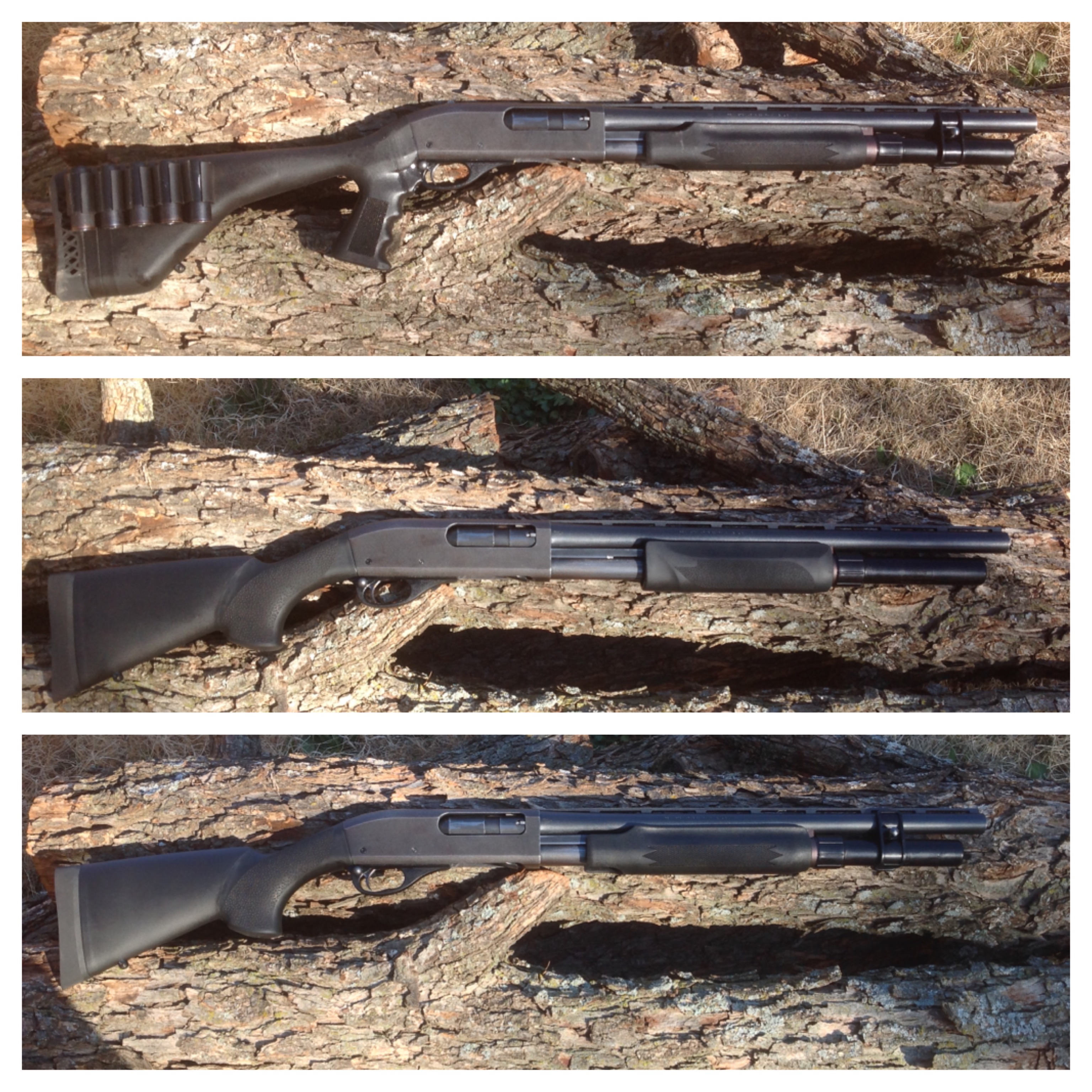

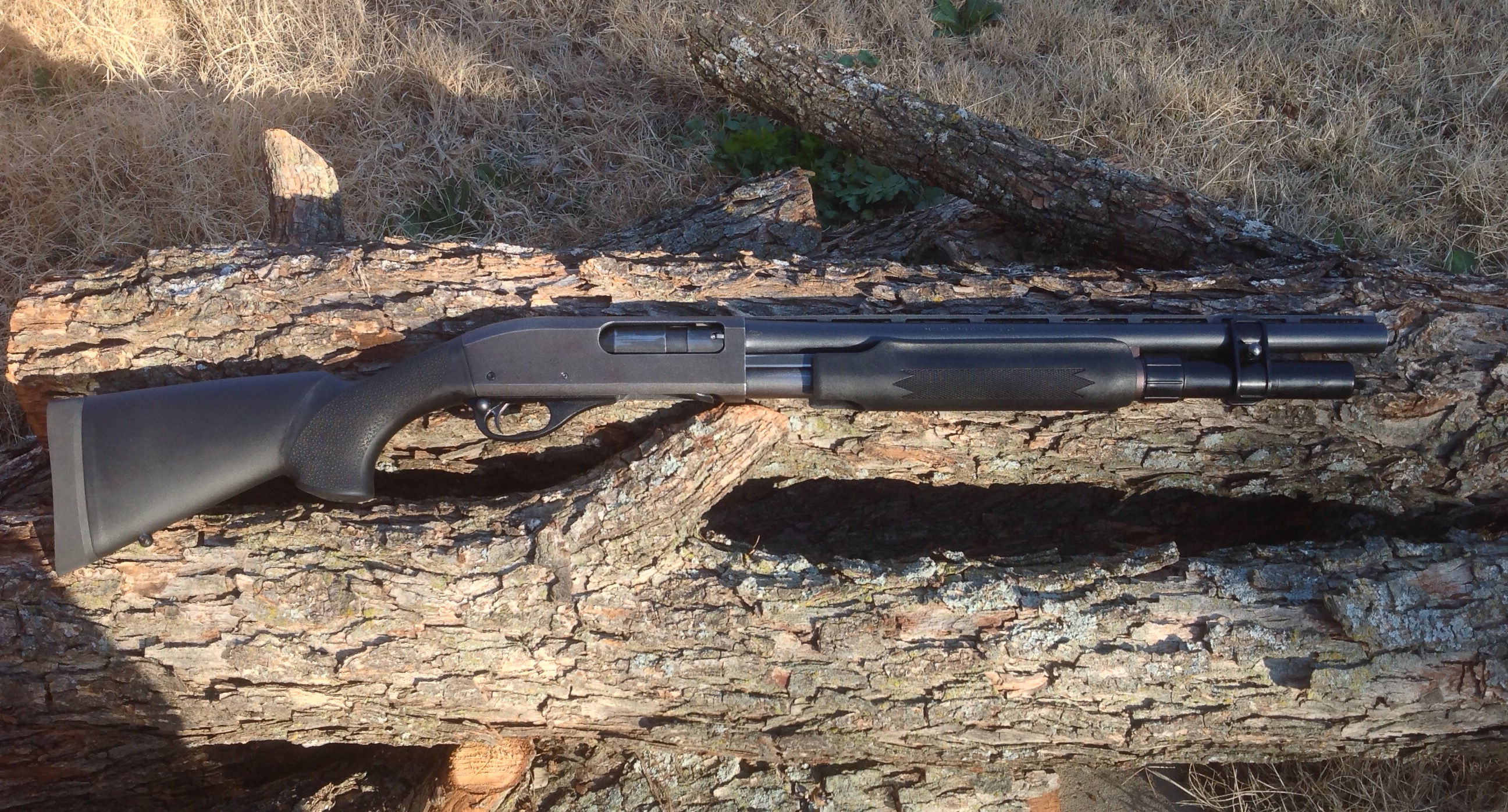

Hogue overmold stock with 12" line of pull and a Remington synthetic sport fore end.
The Remington synthetic sport fore end cycles the shells 100% of the time.
The Hogue fore end seems to not want to cycle the last shell unless you really pumped it EXTREMELY HARD.
IT fit well and looked good but seemed rub or drag a little on my express super mag.

oriyen, is that Choate stock on the first pic? Do you like it?
Yes it's the Choate stock. I like it but surprisingly the Houge stock feels so much more natural when you shoulder it. As soon as you shoulder it in a squared up stance you're looking down the barrel. And I am 6'"3 tall and weigh 315 pounds. With the pistol grip I had to make slight adjustments to see the target clearly.
I was a little worried the 12" line of pull wouldn't work for me but it is just about perfect for me.
That's a nice shotgun. I, too, like Hogue's furniture. One thing I've found rather often when installing their forends is a bit of interference when cycling the shells. The upper edges of the forend tend to drag along especially under dynamic rapid action work.
The Hogue forend needs special attention to getting it centered upon installation. The integral bracket allows a bit of play to port or starboard and this increases the issue. Make sure the forend slider and the Hogue forend are centered while tightening the tube nut. I use a couple of toothpicks as shims to keep the forend centered while tightening the nut.
Even when properly centered there is still enough flex in the rails and the forend that contact may occur. I now always remove some material from the upper edges with a sandpaper block. Its easy to do and looks fine while leaving enough clearance to avoid any interference.

Thanks Holmes375 for the information and comments.
I Wil revisit the Hogue fore end after I smooth it out a bit.
