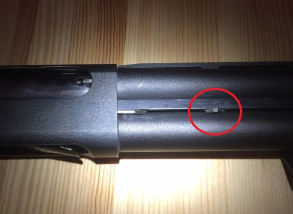

I read this review and it sounded very interesting to me, I'm trying to figure out how I could I get this done but upon checking the rails they do not seem thick enough to add such modification on the action bar. Unless it's welded or staked in some form added to the action bar?
- 870.png (297.09 KiB) Viewed 10069 times

I believe the extra material was built up weld that was then shaped & refinished, but it may also be a part that was made separately and then brazed or soldered onto the action bar. Either way, it's a job for a good gunsmith or some other equally-skilled & -equipped individual.
What do you use your 870 for? Unless it's a dedicated competition gun, I wouldn't recommend this modification, as it'll only really serve to add slide resistance and make shell change-overs & unloading the chamber more complicated.

well bought it with a field 28" barrel for hunting, bought a shorter 20" barrel for home defence I kind of like it better for home defence will be getting another for hunting.

For a recreational gun, do whatever floats your boat. I wouldn't recommend this modification for a HD shotgun, however. No one is realistically going to be shooting that fast in a defensive shooting; it's a waste of ammunition given a shotgun's limited capacity, and working the slide that quickly under the stress of a life-or-death confrontation is just begging for a short-stroke or some other user-induced malfunction. With a proper magazine spring and a realistic magazine capacity, an unmodified 870 can be fired as quickly as the shooter can get it back on target. With no real rate-of-fire improvement then, all this mod will do is make change-overs trickier.
