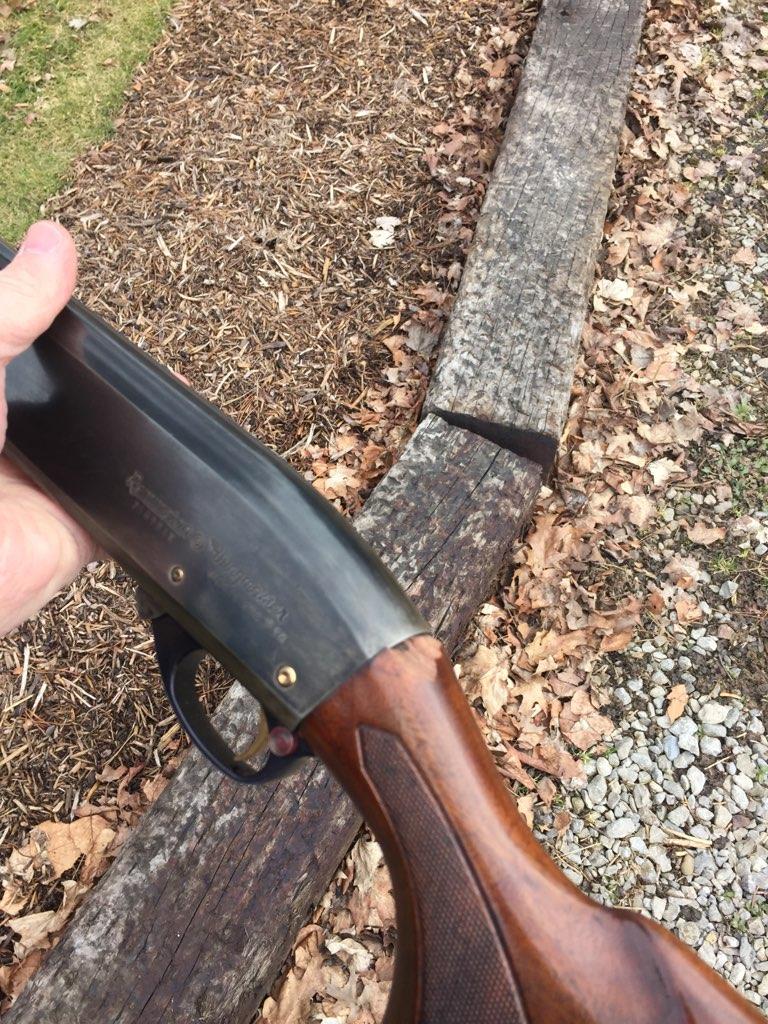

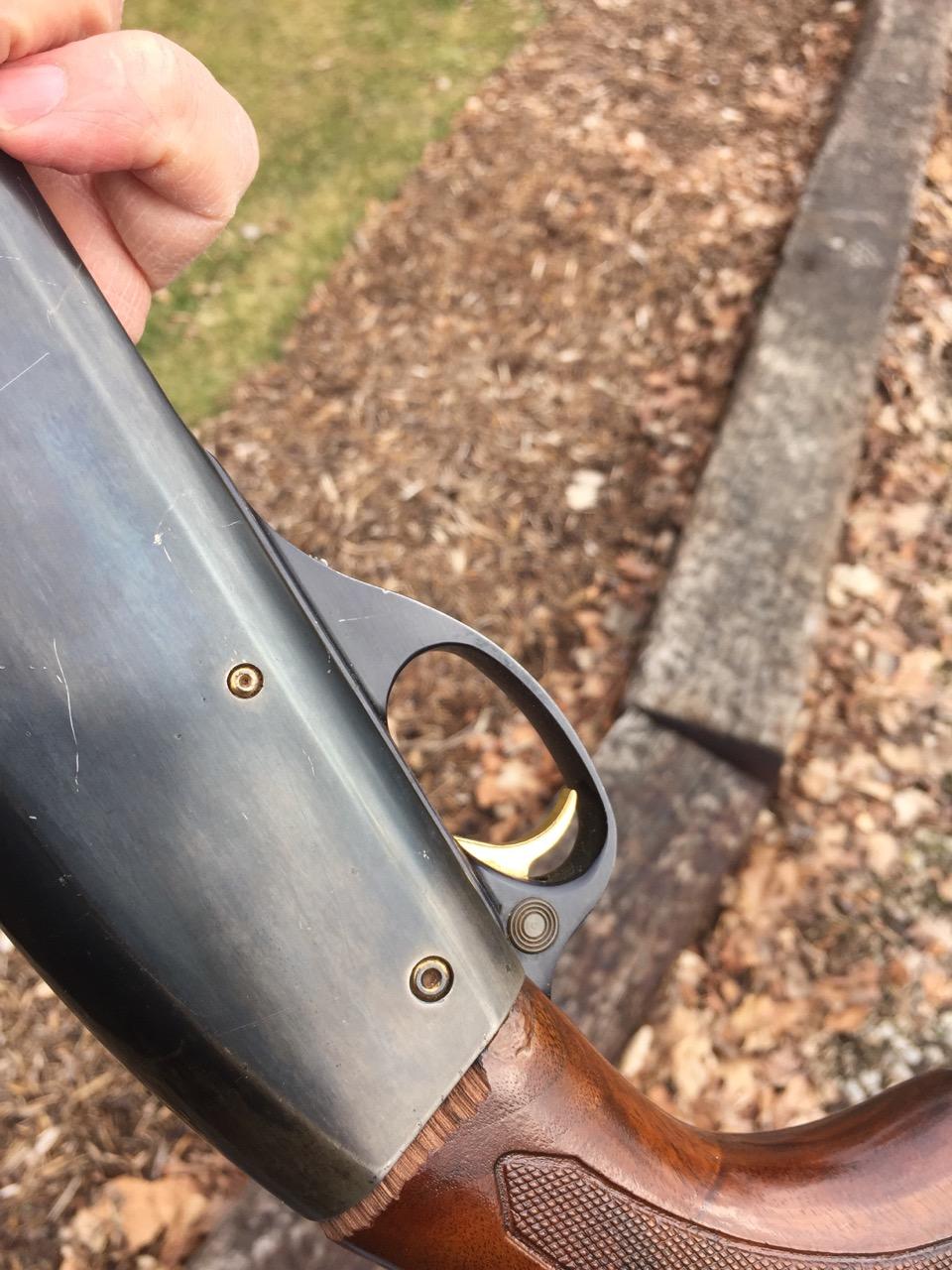

I dont know for sure if this is a failed attempt at adjusting stock for fit, but if you DO attempt it please make sure there is a slight gap between the stock and sharp outer edge of the receiver socket. If I were to try it I'd probably bed the wrist into the receiver, not rely on a tapered shim alone.

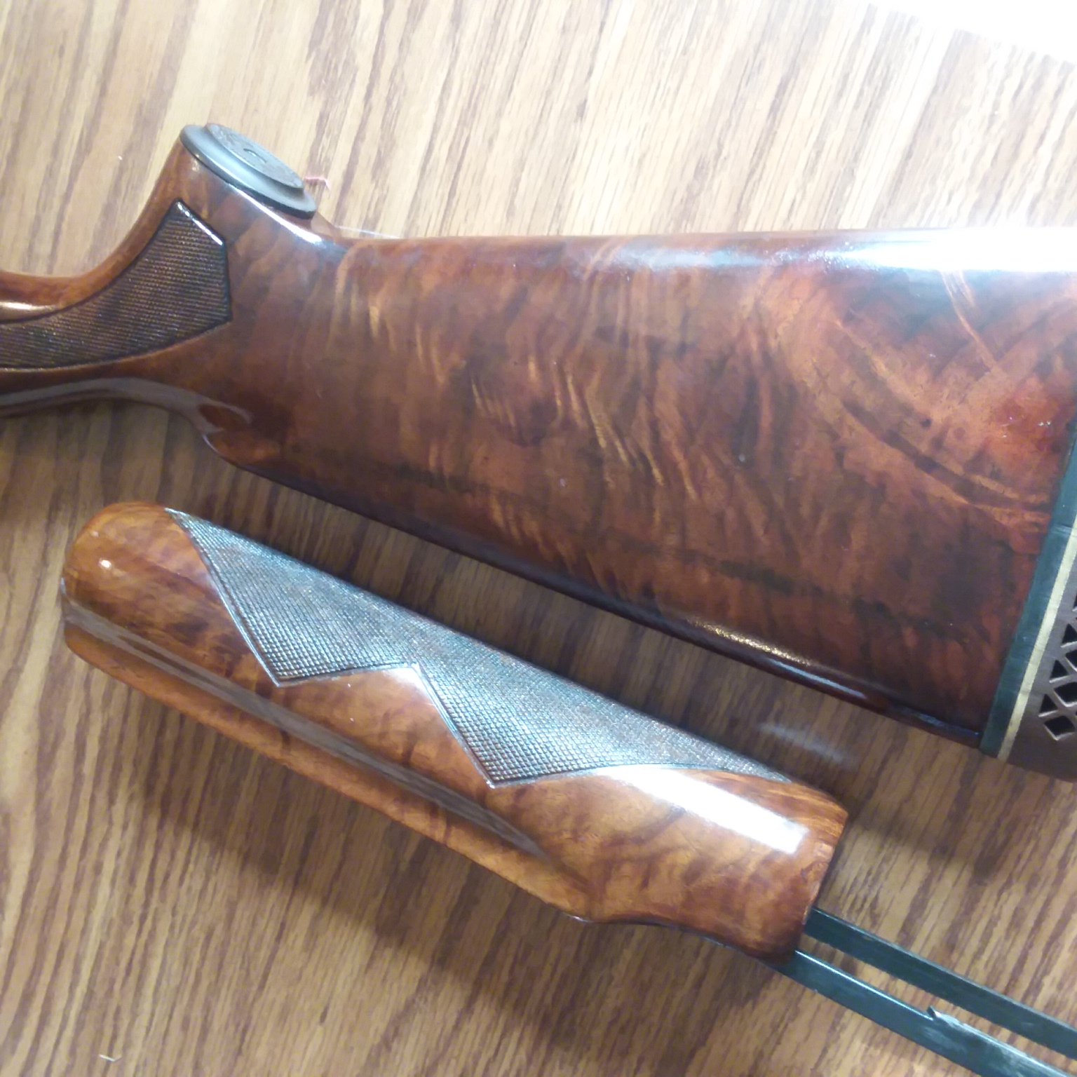

That's some NICE figure in the buttstock, but such a shame to have the wrist ruined in that fashion.
