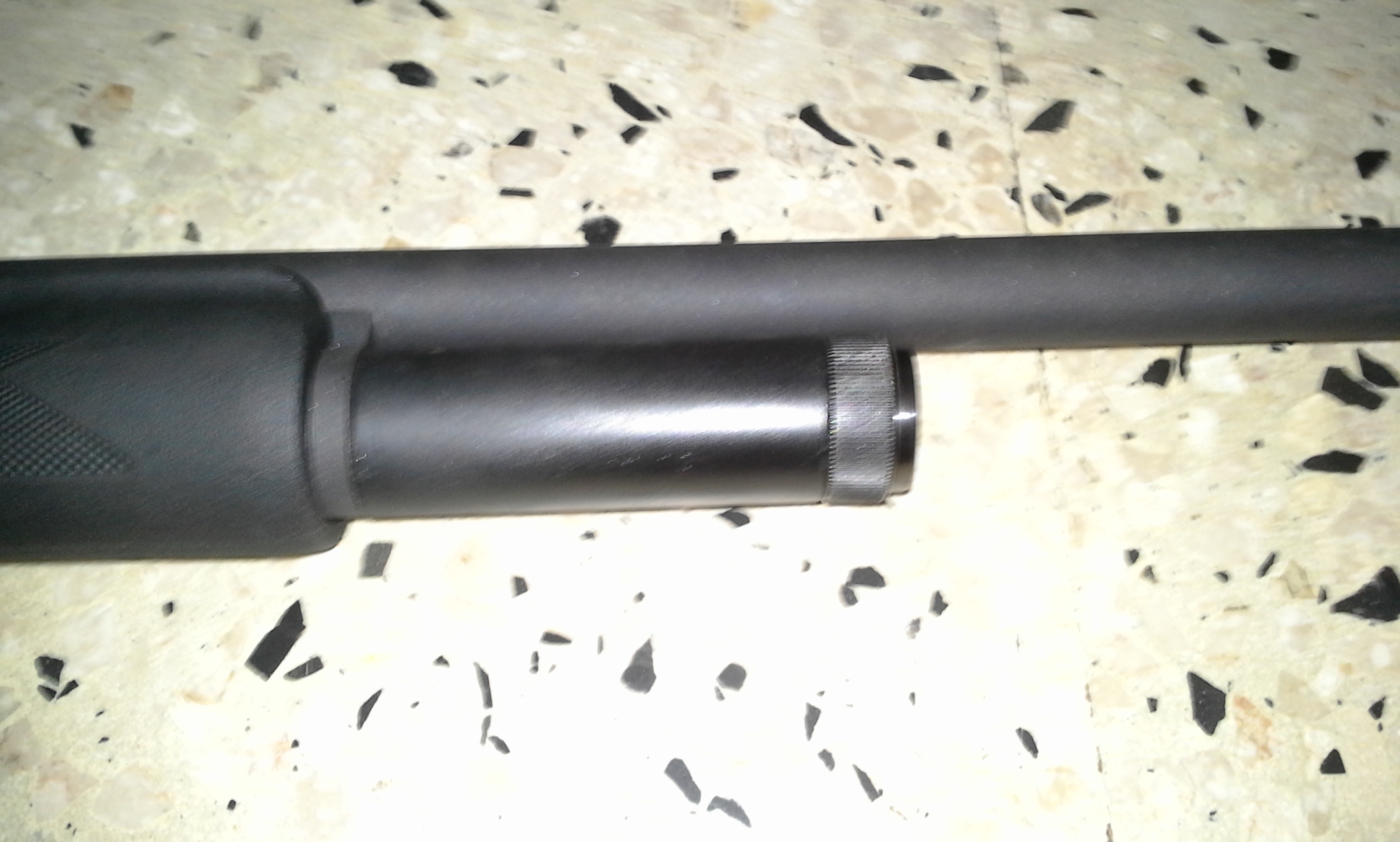

my synthetic butt stock has a machined brass nut, my pardner pump is the field version 28" vented barrel, even though I have changed the barrel to a 20" Remington target tactical sports barrel along with a spacer I got from a gentleman from Sparta MI who makes these spacers for the Hawk 982, NORINCO, NEF equivilent as well as H&R pardner.
here's photo of the spacer mounted on my pardner pump.

it cycles just fine with the target tactical sports barrel, even though the target barrel may have some slight differences but function is great. H&R witch is a owned by Remington, H&R does not make shorter or longer barrels for sale for the pardner pump, this I know because I had another pardner pump my very first but it had a bent magazine tube so when I called H&R THEY TOLD ME TO SEND IT TO Remington in Ilion N.Y. everything else was done through Remington. I also asked if they offered a shorter barrel for the PP and they said no they do not. Remington barrels will fit the PP just fine but since the barrel lug is in a different location it need's the spacer.
