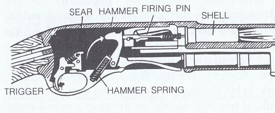

I do a lot of waterfowl hunting and can't seem to find any upgrades on larger trigger guards which allow thicker gloves to be used. Any thoughts or suggestions? Much appreciated.

Sorry to say, I've not heard of any larger, aftermarket trigger guards.
Re: Upgraded trigger guard
The trigger guard on an 870 is an integral part of the trigger plate, which is what all the little bits & pieces of the gun's trigger mechanism attach to. This makes it a pretty complex part, which is why Remington has only made them out of molded plastic or powder-cast aluminum, and why you don't really see aftermarket trigger plates being sold.
In addition, if you cut an 870 trigger plate in half, you'd see that there's a reason the 870's trigger guard has its characteristic shape. The solid section right in front of the trigger opening houses the hammer spring & plunger, and the safety mechanism sits right behind the trigger. So, even if someone did make an aftermarket trigger plate, they'd have a hard time really enlarging the space around the trigger without making changes to other elements of the 870's fire control.
My advice would be to try thinner gloves, gloves with removable fingers, or taking your gloves off to shoot.
