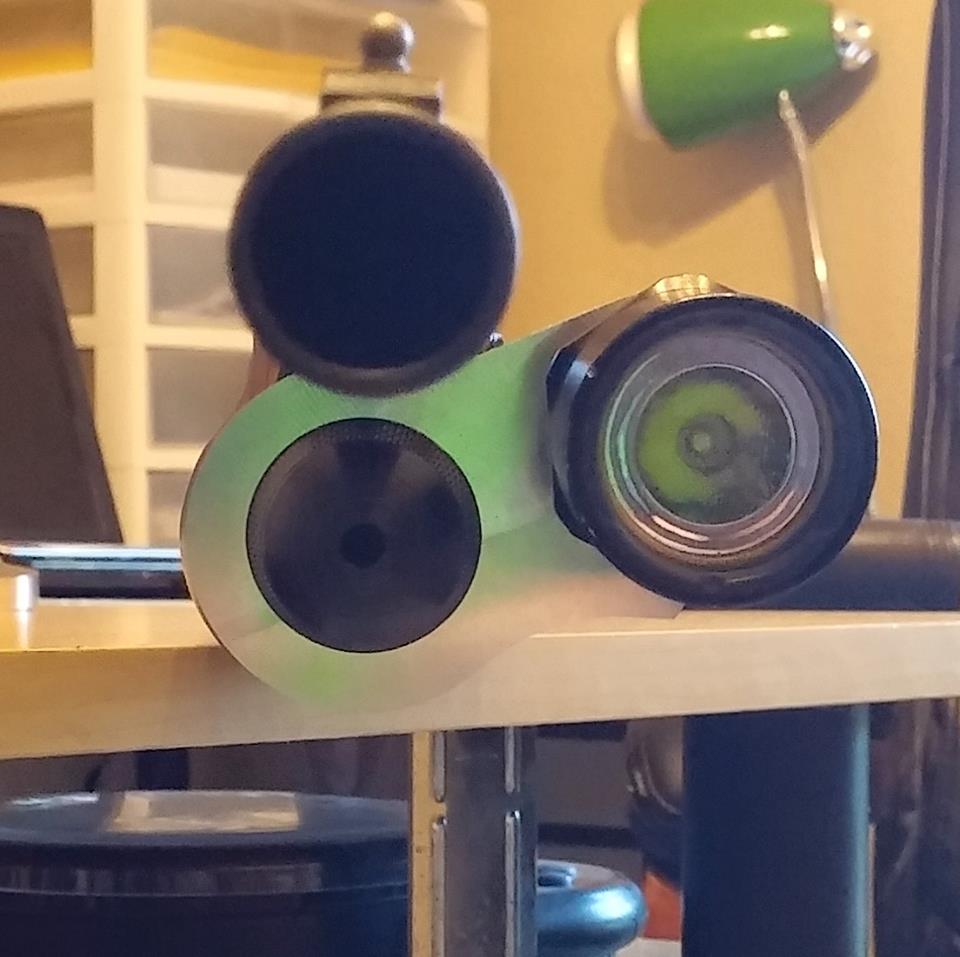

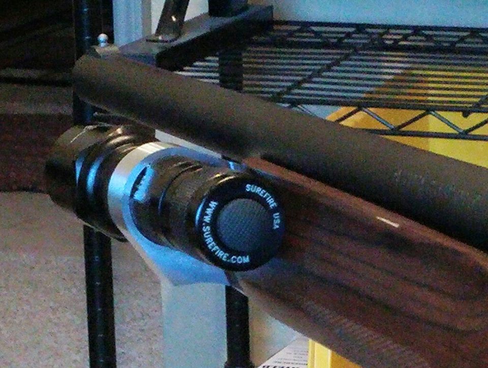

CDM Gear announced flashlight mounts for 20 gauge Remington 870 recently.
- cdm_gear20gauge_flashlight_holder2.jpg (126.35 KiB) Viewed 9447 times
- cdm_gear20gauge_flashlight_holder.jpg (75.05 KiB) Viewed 9447 times

The CDM is what I've wanted for the past year or two, but it has been very difficult for them to bring it to market. Here's hoping it shows up soon. I'll buy several!

CHECK THIS OUT FROM CDM. ORDERED MINE TODAY:
The UL Series of shotgun light mounts are machined from solid 6061-T6 aluminum billet and hard anodized to a Mil Std. Type III hard coat finish. This is a “NO TOOLS” mount and we designed this mount for added strength by incorporating a way to use the barrel lug as an additional support reducing rotational movement of the light mount. The UL series will be available in a 1” light version currently. Because this is custom machining we can only approximate completion dates but we expect to ship no later than November 16th, 2015.
You can check it out and place your discounted order at this link until November 6th at which time the offer will expire and the MSRP will replace it.
http://cdmgear.com/ULRemington20ga.html
NOTE: Our initial UL series light mount for 20ga. Remington shotguns will not have a sling mount at this time. This mount was designed and built around the 20ga. Remington shotgun without a magazine tube extension. The non extended magazine tube uses a retention device under the magazine tube cap which is not used in magazine tube extensions. We can not guarantee that the magazine tube will not unscrew itself during recoil without a clamp to stop the rotation and this light mount does not additionally provide that function.
