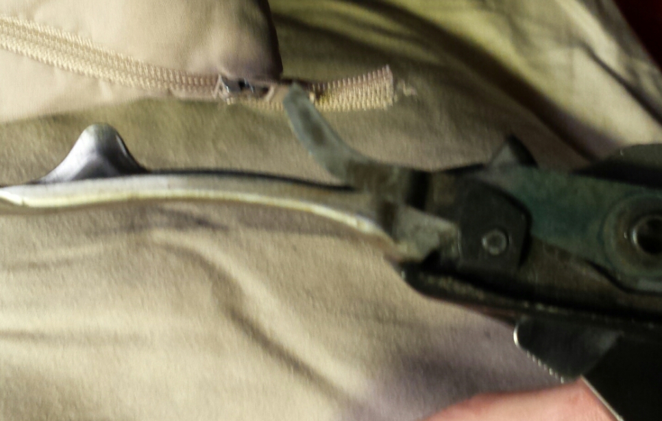

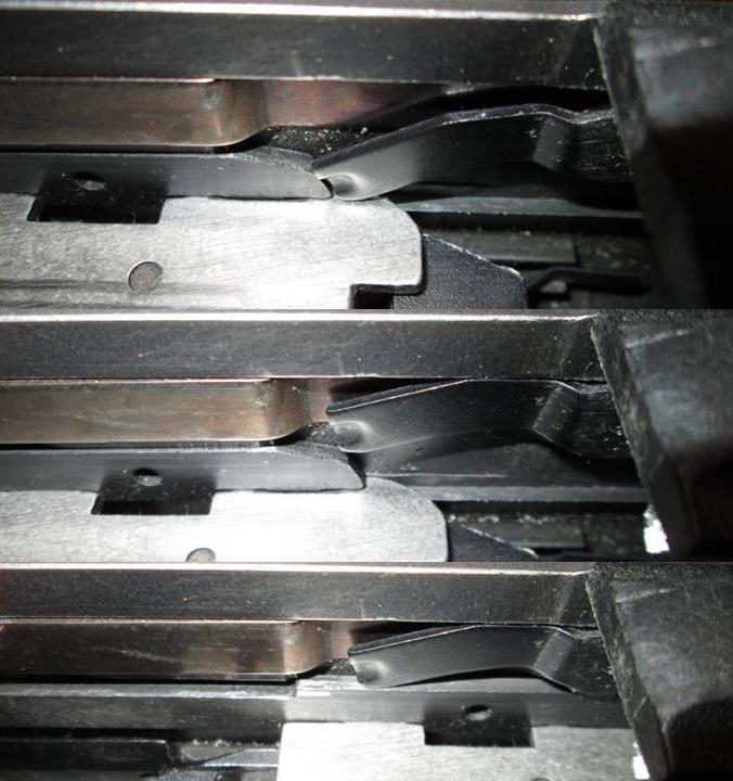

Also, what does the end of your left action bar look like? As you can see in the following image, the left action bar on my 870 has a chamfered end that allows the slide to start moving rearward even if the action bar lock is not fully depressed.
I know Remington has changed the design of the 870's action bars at least once since the gun was introduced, so maybe your older action bars don't have this feature.

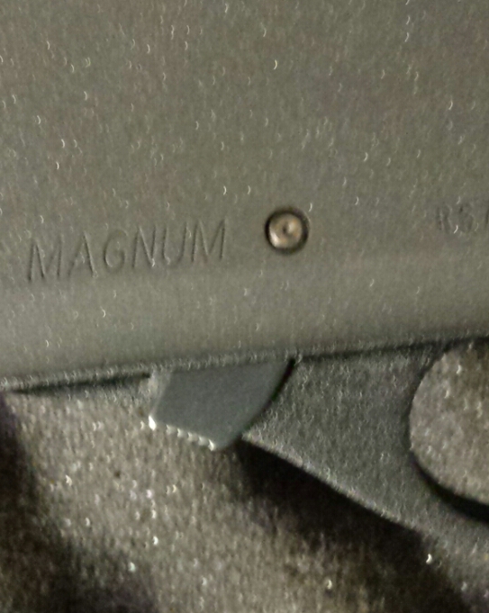

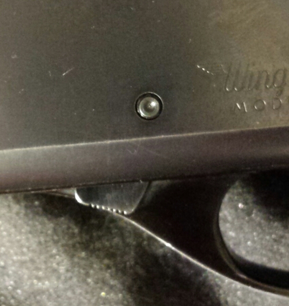

Great suggestions. I took some pictures. It looks like the action bar lock designs are different. Also in the pictures, I have tried to illustrate the degree of "flushness" of the action bar lock, with the newer one shown as well for comparison. It might not look like much, but it does amount to a (to me) distinctly different feel. "Positive engagement" is the term that comes to mind operating the new one. Now that I know there are different action bar lock designs, I believe I will change mine out to the newer style, assuming there is nothing about the older 870 that would prevent me from doing this. Your answers about which parts to upgrade for "peace of mind" is just what I was looking for. I have removed the retainer because it drives me nuts. I just put the crappy orange follower at the end to prevent spring on inside of magazine contact (maybe useless, but I don't see any real cons). I don't mind the spring coming out as much as I mind dealing with that old style retainer. I've thought about the flex tab conversion. Dies this just require a new carrier, or a whole trigger group? I hear this is a great idea for an 870 which might be relied upon in a self defense scenario. That's not exactly what I've got it for, but I certainly wouldn't mind the flexibility. I've aalso thought about converting it to a 3" receiver. I don't really need to fire 3" shells, but I do have a new 3" barrel on it, and it does drive me a little crazy having a barrel that says 2 3/4" or 3" knowing full well the 3" will not eject (that's right, isn't it?). Thanks again!
New action bar lock
New action bar lock

Old action bar lock
Old action bar lock
2015-04-27 09.32.07.jpg (345.98 KiB) Viewed 6491 times

Also, no discernible difference in shape of left action bar lock. Both looked just like yours.
Old action bar lock, engaged with as little depression as possible
2015-04-27 09.37.33.jpg (207.24 KiB) Viewed 6487 times
New action bar lock, engaged with as little depression as possible
2015-04-27 09.37.02.jpg (225.22 KiB) Viewed 6491 times

Also, looking at the pictures, "flush with the receiver" was an incorrect description. Flush with the trigger guard would have been more accurate.
