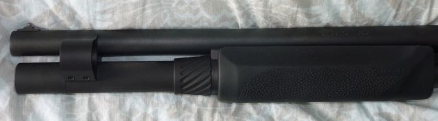

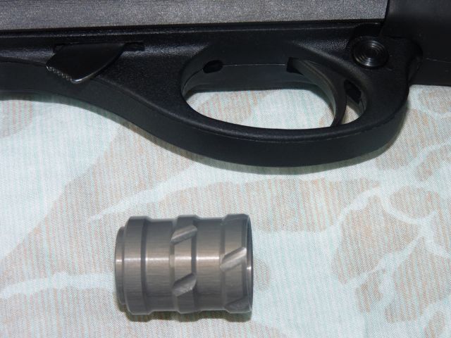

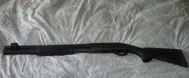

Here's some pics of the Nordic Components teflon-coated aluminum follower I received today along with the +2 extension and extra long end cap I installed yesterday :)
My issues are no longer extraction related. My local gunsmith honed and polished my chamber under warranty and it extracts everything I feed it now. However, it's still stove-piping some rounds, and the ones it doesn't, they just drop out of the receiver like they were just flicked. If there's something I can do to the ejector to make it function better, I'm all ears.
