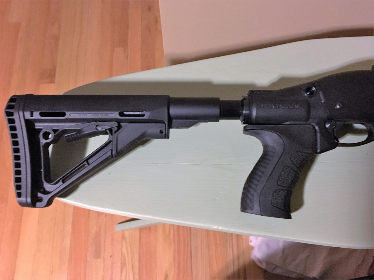

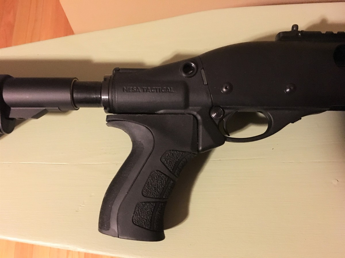

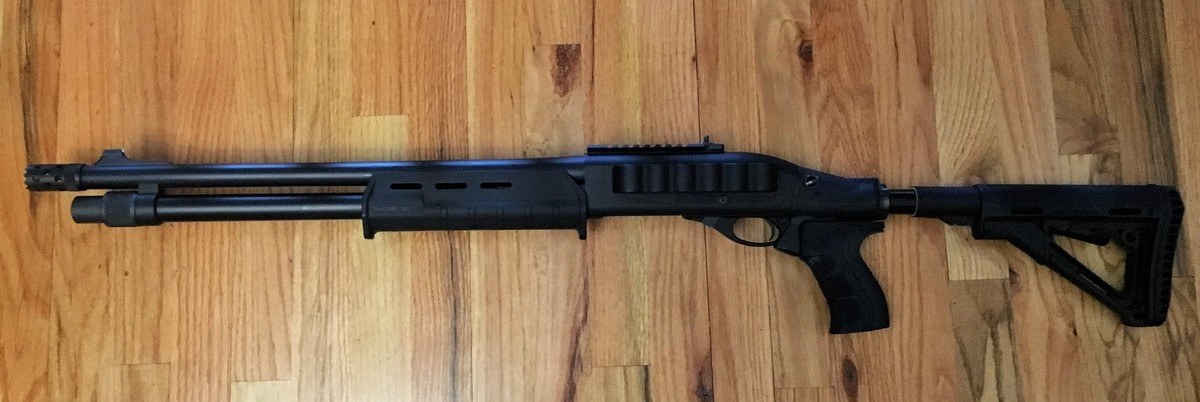

I picked up an ATI AR-15 x2 Scorpion Recoil Pistol grip and modified it to fit my Mesa LEO.
It is quite soft, and has a much better grip angle for your hand. Much more comfortable.
