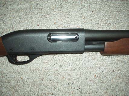

It took me an afternoon to polish the bolt in my 870 Express. I broke down the parkerizing with steel wool, then went to work with newspaper and Happich's Semichrome polish. Well worth the effort.
Polished Bolt resized.JPG (32.8 KiB) Viewed 16701 times

That looks fantastic. I have not been brave enough to try this yet. How difficult would you say this was to do? Also have you shot the gun yet since doing this?

RainMan_JH wrote:That looks fantastic. I have not been brave enough to try this yet. How difficult would you say this was to do? Also have you shot the gun yet since doing this?
It was an easy process; I worked on it while watching television one afternoon. The shotgun fires no differently with the polished bolt than it did prior to polishing.
Go ahead and take the plunge. I think you'll find (as I have) that tackling and completing projects like these are very rewarding.
