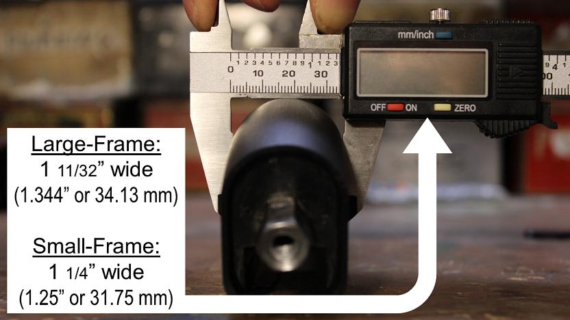

Re: What stock brands fit the 870 20 Gauge?
YankeeZulu wrote:I'm typically not one to resurrect a thread, but I got the wife an 870 Express 20 Gauge for Xmas and am wondering what kind of synthetic options are out there for them. Hogue makes no-nonsense polymer furniture for 20 Gauges as well.
What don't you like about the stock that's on it now?
YankeeZulu wrote:FYI- If your SG's serial # ends in "X" or "N", it has a large frame and will accept 12 Gauge accessories. Those ending in "U" or "K" are small frame and will only take 20 Gauge-specific items.
That applied to pre-RS serial numbers, but under the new serial number system, the letter at the end varies, and doesn't mean anything, so you can see small-frame guns with serial numbers ending in "X" or "N" as well.
Stocks for the 870 aren't complicated. You have large-frame (12, 16, and some early 20ga) and small-frame 870s (current 20ga, 28ga, and .410); and stocks are either designed to match large or small receivers. If you're not sure what receiver size you have, it's easiest to simply measure it:
870 receiver widths.JPG (50.27 KiB) Viewed 21318 times
You can also put any large-frame stock on a small-frame receiver using an adapter, as mentioned previously in this thread.
For more information about stock interchangeability, as well as other aspects of removing & installing stocks, see this video.

I have never looked at the stock end of a receiver on either the 12 or 20 ga guns but do they mount up the same ?
Center Bolt, same bolt size, what about the alignment slot (for lack of the correct term) same size ?
Once I find both guns I need to measure everything, then find out if I can actually mount a 12 ga High Tube Mount to the 20 ga receiver. From measurements above the 12 ga is only 0.090” wider, this shouldn’t be any problem if both stock mount in the same way. Split up the .090 = .045 both sides, that is less than a 16th of an inch, I would hope I can make a plate to cover the edge… if needed.
Thanks for any information, I am on hold in getting started, I first need my stock in hand before disassembly.
NnF000 wrote:Once I find both guns I need to measure everything, then find out if I can actually mount a 12 ga High Tube Mount to the 20 ga receiver. From measurements above the 12 ga is only 0.090” wider, this shouldn’t be any problem if both stock mount in the same way. Split up the .090 = .045 both sides, that is less than a 16th of an inch, I would hope I can make a plate to cover the edge… if needed.
Those measurements are for the outside of the receiver. I believe there's more of a difference between the stock mortises. Mesa Tactical makes an adapter that will do exactly what you want to do, why not use that?
