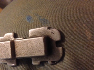

Slide assembly with A and gash on slide
Post by Page870MAG »
I just bought a new 870 super mag went to clean it for the first time and saw this...... Anybody ever seen this

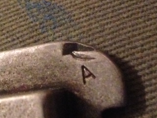

Re: Slide assembly with A and gash on slide
You only have to create one topic.
That's interesting, can't say I've seen that before. You said this gun was brand-new?
I've never seen such mark before, too.
Post by sven »
It might grow larger and deeper by time until it cracks off, but if it would interfere with function afterwards is still a question. I guess a prepper would immediately call Remingtons to ship a new one on warranty.
