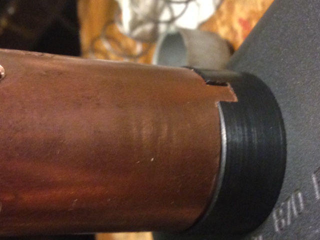

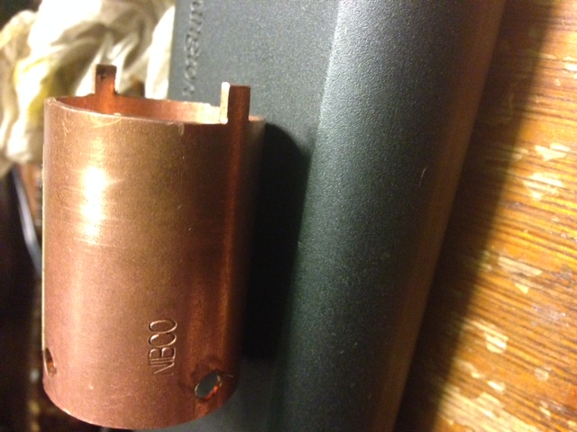

I made one from a 1"-heavy walled copper pipe coupling,from Home Depot's plumbing dept.
Just dremeled out the recesses.Teeth measurements are .15-.16.Plus I added 4 holes for a cheater bar.(ok,its a allen key).
Cost me around $4.00,plus 30 minutes with the dremel,filed,then polished cut edges with a cratex wheel.
