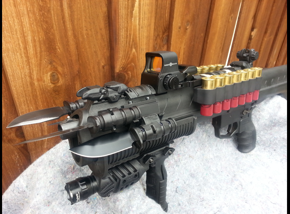

So I says to my wife, I'm fixin to turn 40, I'm going to the gun show to buy a shotgun. She says, OK don't spend more than 2000 dollars. I was in my truck before she finished the word dollars, and pictured below is the result of my well deserved shopping spree. I'd say the accessories are 4 times the price of the gun, it's18 pounds fully loaded and I've probably stabbed myself a dozen times. So it's not my first choice for a home defense scenario, but by God if the zombies ever attack this beast is coming out of the gun safe.

Not sure about the zombie gun application, but that's definitely one heck of a range toy.
I have to ask though, four bayonets and fourteen rounds in sidesaddles but no magazine extension?

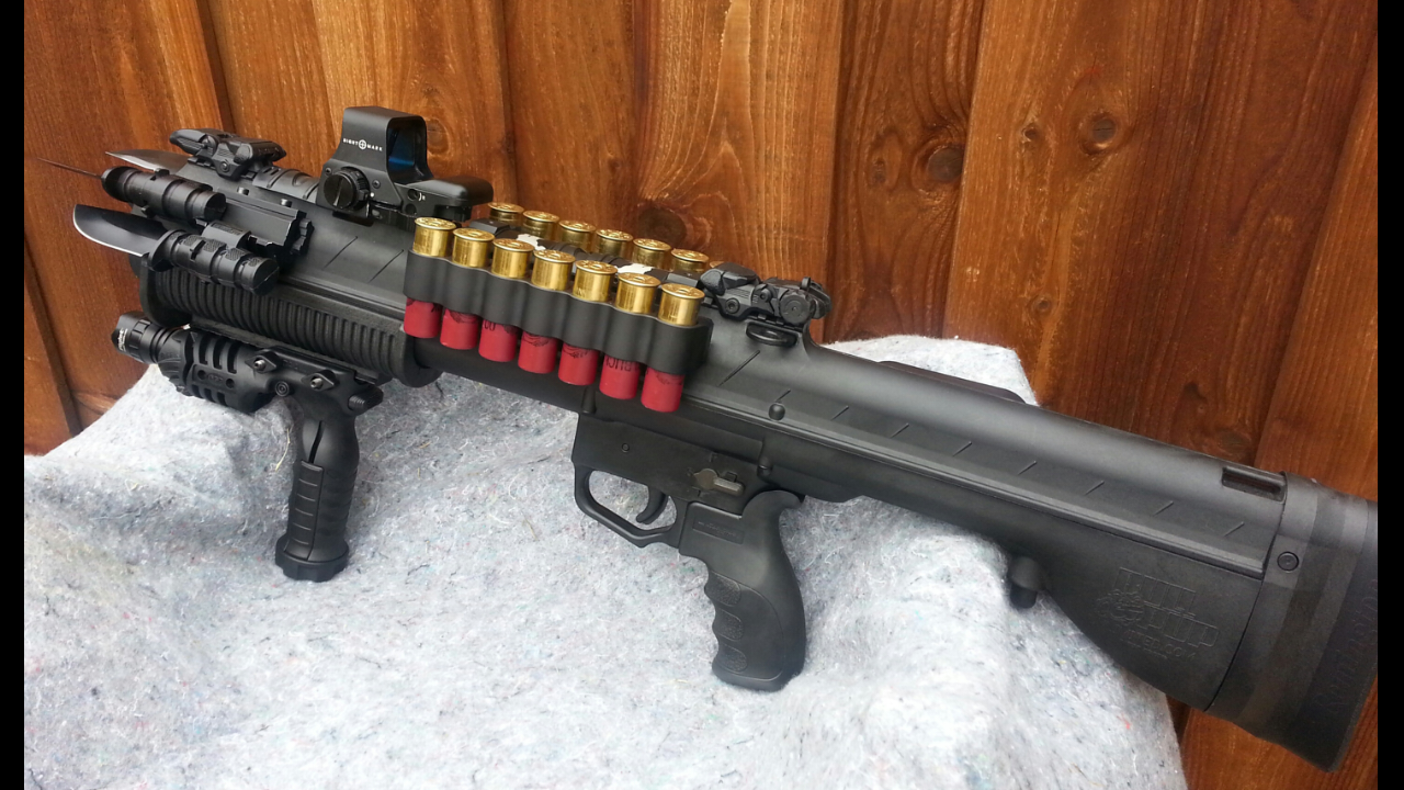

It's hard to see from the pics but that is the 6 shell magazine tube. So all I could fit would be a 1 shelll extension, and I think those were 70 bucks. Didn't seem like it was worth the cost.

I figured you were using one of those long-mag 870s. A +1 may not be a game-changer, but an extra shot is an extra shot, and they're not that expensive. You can get good, single-piece +1 extensions like the Wilson Combat kits for $45 - or less, if you find a used one like I did.Capt367 wrote:It's hard to see from the pics but that is the 6 shell magazine tube. So all I could fit would be a 1 shelll extension, and I think those were 70 bucks. Didn't seem like it was worth the cost.
It's your toy though, so do what you like. I was just curious.

I would like to make a suggestion to you, with explaination. I cannot say my suggestion is the right way and that yours is wrong. I would have done it differently.
My suggestion is to remove your vertical foregrip and install an angled fore grip. Here is the reasoning: When cycling the action using the vertical grip, there is a tendency to pull the grip to the side you are pulling from thereby twisting the action bars. With the flashlight setup you have, you cannot get a good enough grip on the bare fore end, so you need something to get a grip on. Look at the Magpul AFG grips. They will put your foreward hand in a different position and change how you cycle the action. It will become a smoother front to back motion instead of the pulling to one side. It will save your action bars and your sanity.
