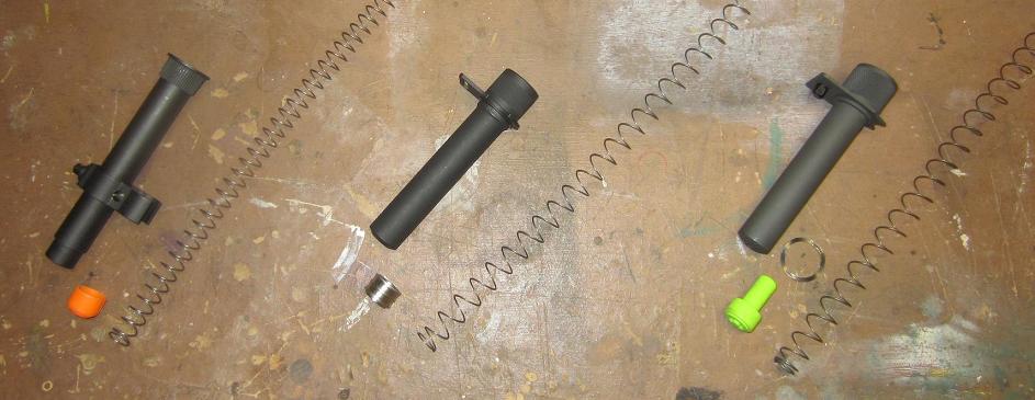

I'm currently working on a detailed, comparative review of three popular +2 magazine extensions for the 870: the factory Remington +2, the Vang Comp +2, and the Wilson Combat/Scattergun Tech +2.
Left to right, Remington, Vang Comp, Wilson Combat/Scattergun
While I'm still in the T&E phase, I figured I'd give y'all an opportunity to chime in. If you've used any of these extensions (including +1 or +3 variants), please feel free to share your thoughts and experiences.
Why did you choose the extension(s) you did? Have you had any problems that I should try to replicate? Any quality issues with the finishing, machining, or workmanship? How well do their respective sling mounts work with your build and for your purposes? Any difficulties during installation (besides removing magazine tube dimples)? Anything you think the designers should have done differently? Are there any mods you would recommend?
If the version of your extension is different from the ones pictured, of if you use different springs, followers, or other parts, please specify.

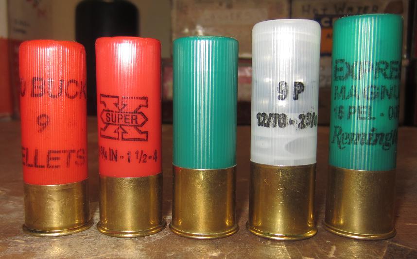

That Rio buck could certainly have been part of the issue. I have some Rio Royal shells, and they're much closer in length to 3" shells thanks to their very shallow roll crimps. They're still 2.75" shells, and no shotgun should have issues cycling and chambering them, but their crimped lengths are longer than SAAMI specs, which can reduce capacity in tube magazines designed for normal 2.75" shells.
Left to right, Estate 2.75" 00B, Winchester 2.75" 1 1/2oz #4 shot, Remington 2.75" Slugger, Rio Royal 2.75" 00B, and Remington 3" Magnum 00B.

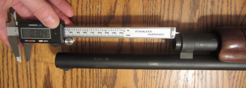

For those who want to contribute, something else that would be helpful and appreciated for this project are measurements of the length of the magazine tube's thread that extends past the barrel guide ring with the barrel seated in the receiver. You don't have to have any of the extensions I'm reviewing, just remove whatever extension or cap your gun has (along with any under-cap sling plates or other accessories), make sure the barrel is fully seated in the receiver, and measure the distance from the front of the barrel guide ring to the end of the magazine tube.
I have several barrels that I can measure, and I plan on sampling some 870s in the local gun shops as well, but I could always use more data points. I'm especially interested in measurements for older or nonstandard 870s, 870 clones, and aftermarket 870 barrels.
