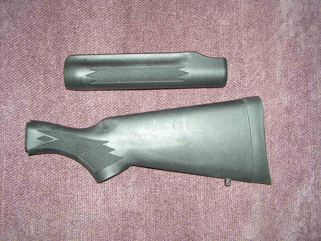

While I'm ranting on stocks, I might as well rant on forends (or forearms, depending on where you're from). I have short arms. The Remington Express Compact Jr. has the best forend I've seen, but they don't make it for 12 gauge models. It's quite long, extending back to the receiver, so if you have short arms there is always something to grab:
[images deleted -- my Photobucket album got full]
The 12 gauge Express Synthetic 7-round has a pretty good forend that is not quite as long as the Compact Jr:
The Hogue forend is very short and really makes me stretch to get a solid grip:
In general, it seems the firearms industry thinks all shooters are gorillas with 36" sleeves and fists the size of hams. I have a 32" sleeve length and wear medium-size gloves. It's hard to find firearms that fit me comfortably without some modification.

If your unhappy with your Hogue 12 LOP stock set, I would trade a factory 12 gauge Remington set?
