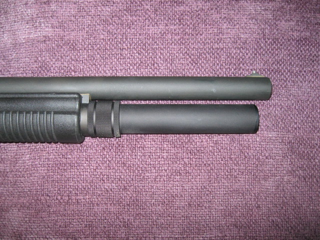

The ATI aluminum +2 extension is a pretty close match to the 870 Police parkerized barrels color. A little darker than the parkerized grey. The extension comes with a spring and I added a S & J follower. Works great, no problems after 50 rounds.
- IMG_0019.JPG (181.96 KiB) Viewed 7233 times
