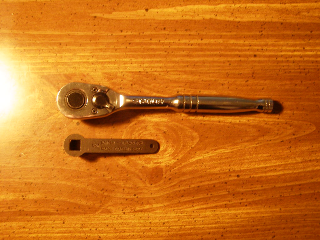

I don't know what kind of choke tube wrench comes with the new 870 Express models, but this one came with one of mine. It has a 3/8 square in it that will allow you to put a ratchet or breaker bar in it for some extra mechanical advantage.

I got the choke tube out. I spayed break free on it, let it sit for 5 mins, this took a socket wrench, but that on the choke tube wrench supplied by remington and gave it a twist. I think I just needed some leverage that I could not get with the choke tube wrench alone. I'm sure the Break Free helped too.
