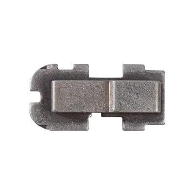

Looking at the parts on the Remington web site. The slide that is in the gun looks like this:
Which according to the Remington site is a "870 12 Gauge Super Magnum Slide Assembly, Police (F401024)" which FITS: 870 Super Mag, 12 - 3.5".
The bolt appears to be a standard bolt, so I think all I need to do is replace this slide with the standard slide.

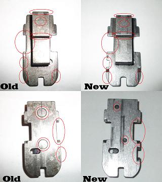

If a SuperMag slide assembly ended up in your gun, that could cause problems. My guess would be that with the bolt in place, the SuperMag slide assembly can't travel back far enough to properly engage the carrier dog. Here are some images of old- and new-style standard 12ga slide assemblies (click for a bigger image). These are the designs used in all magnum (3") and non-magnum (2.75" only) 12ga 870s.
Your best bet would be to get a new-style slide assembly, since that will work in both older & newer 870s and give more reliable function. You might be able to save a little money on a used one, but brand new ones are just $17 - $23 (depending on the finish), and can be ordered directly from Remington by calling their customer service department. If you need further help, we can answer questions about slide assembly part numbers or used part listings, or help you identify possible issues with other components.

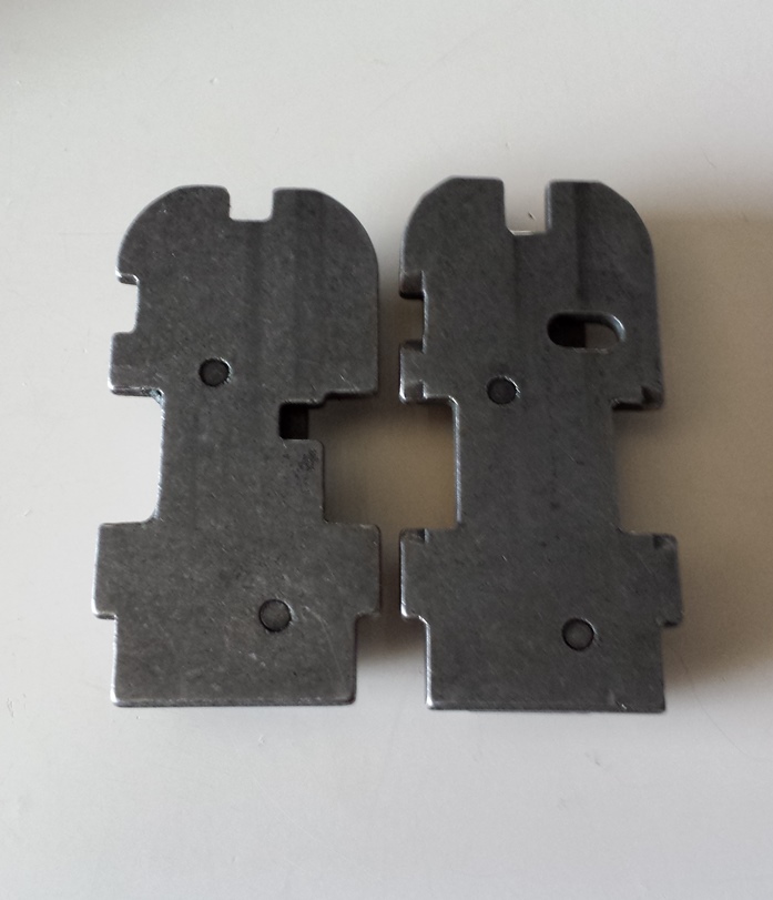

My replacement slide came in today. The one on the left is the one that was in the gun when I bought it. It's the one that the Remington site shows to be for a 3.5" Super Magnum. The one on the left is my replacement and as you can see is very different. Once reassembled with the slide on the right, the gun cycles perfectly.
