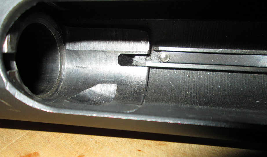

If you open the bolt and look inside, how well is the ejector fitting into the rear of the barrel? This is what keeps the barrel aligned in the receiver.

Synchronizor, thank you for posting that photo. When I look inside I see exactly what I see in the photo you provided. I'm comparing the relationship of everything I see to everything else and it all looks as it does in the photo. I may go back to the shop I bought this and check the second one they have and see if it too is loose.
