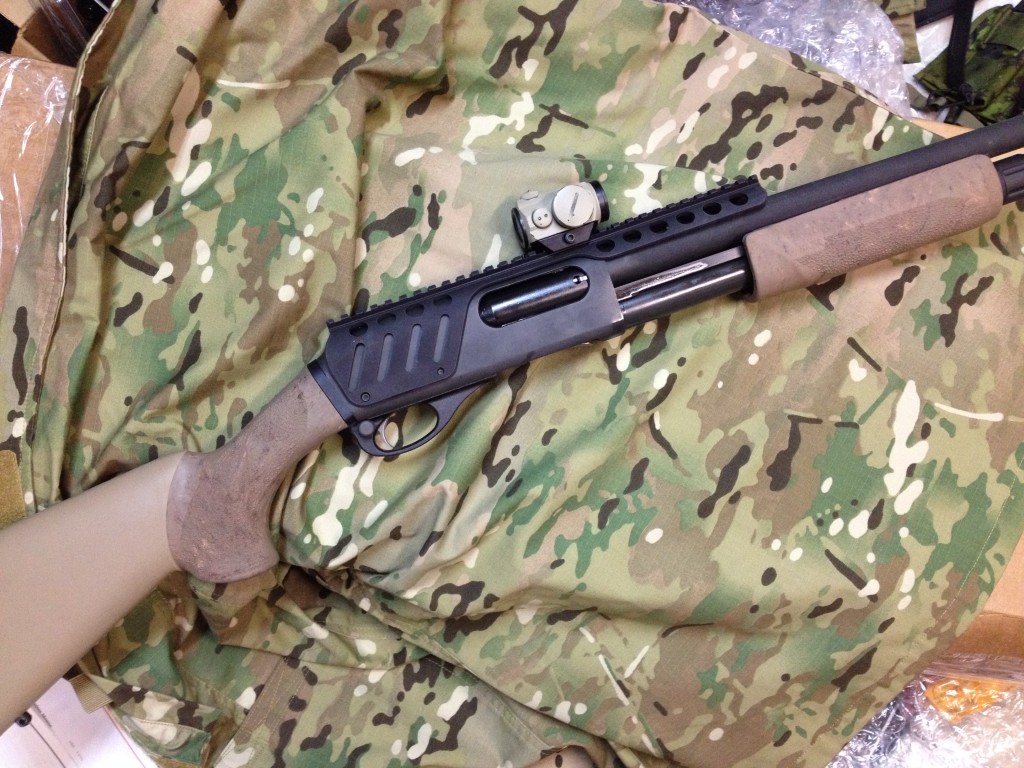

A customer just sent us some pics of the gun we built for them
We have taken new in box Remington 870 Tactical shotguns and completed the following work
Striped and honed action. Smoothed and polished action inside and out including magazine tube.
Stripped, honed and bead blasted pump forend.
Stripped polished and bead blasted trigger pins, stock nut, and forend nut
Strip and 3 stage polish bolt until it’s as smooth as chrome.
Striped and polish bolt carrier until smooth
Bead blast and Mil spec phosphate finish every steel part by it’s self
Remove old extractor and install metal police extractor.
Install machined 7075T6 single point sling mount
Install 4140 steel over sized safety button
Install No jam bright green machined magazine follower
Cut install and test +power high quality magazine spring (650,000 cycle life)
Install solid machined 4140 steel +1 tube with 3 position sling plate
Install Hough short LOP or standard LOP black or Tan over molded stock set
Install 4 shot DSC on butt stock ( Detachable shot shell carrier)
Supply 1x 6 shot black ( Detachable shot shell carrier)
Test fire and function test
Knight 870 RAS
Aimpoint T1 micro

Unique and cool Remington 870!
