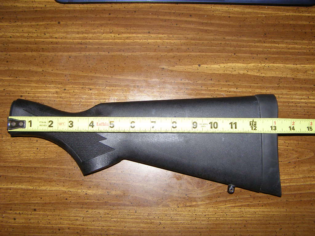

I picked up this used Remington 870 stock at a gun show recently. What length is this considered? I'm guessing 13 inches. Are they measured with the buttpad on or off? Is a 12 inch LE or youth model total 12 inches with pad installed? I would like to try a solid stock about 10 inches in length like my M4 style stock is fully collapsed.

Standard LoP for 870s is 14", and that's a good starting point for average-statured men and larger women, when there's no heavy clothing or gear involved. The stock in the picture you posted is a 14" LoP stock. 13" - 12" LoPs show up on compact models, or on stocks meant to be used while wearing armor or heavy combat gear. Going below 12" is getting pretty darn short - at least for a straight or semi-grip stock.
