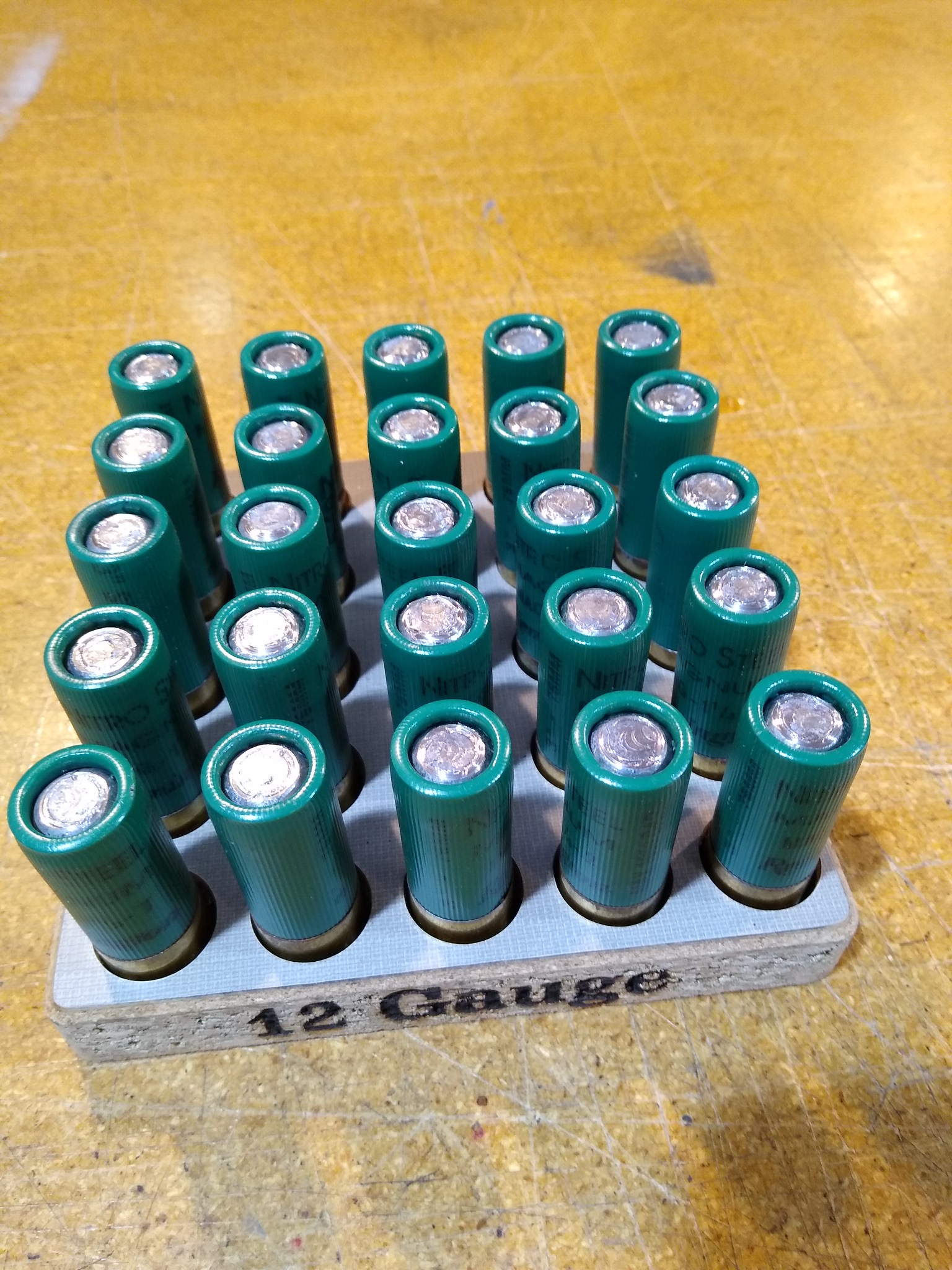

cjg
Posts: 7
Joined: Thu Dec 14, 2023 10:46 pm
Re: Lee Shotgun Slug Molds, 1oz and 7/8oz
Post by cjg »
They work well. That's what I used with these and a roll crimp
