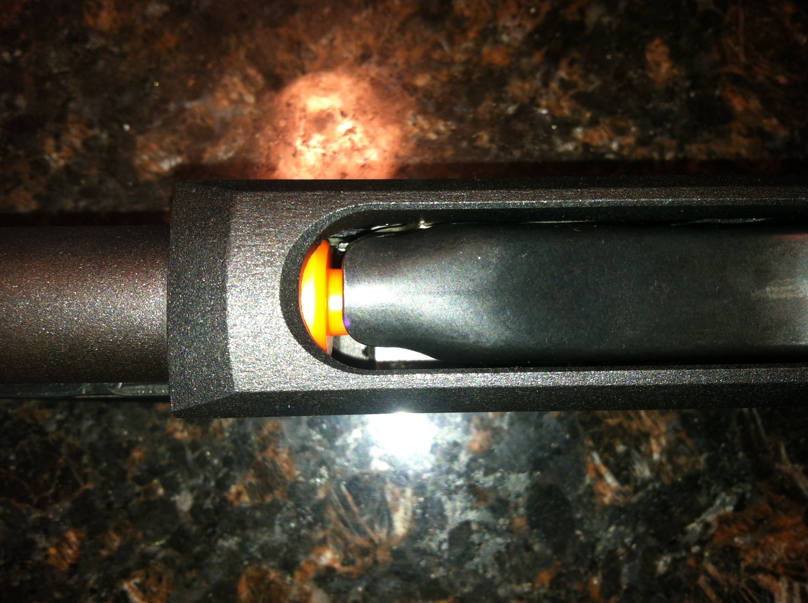

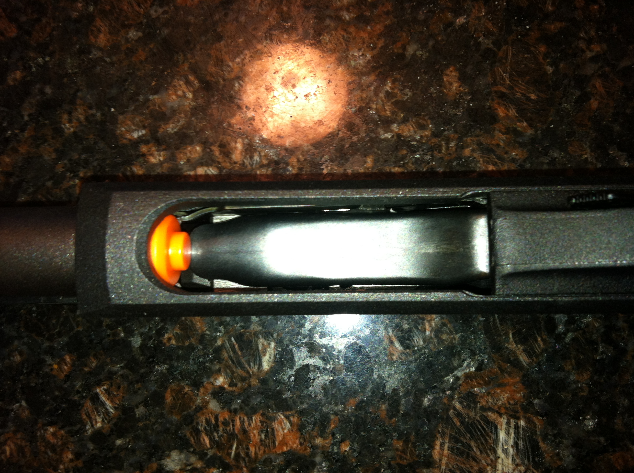

I've attached two pictures. One has the follower in the down position and in the other it is up.
I've been considering a new follower. However, it would have to have the grooves in it to slide past the dimples in the magazine tube. I haven't seen any of those for the 20 gauge so if you know where I could get one that'd be great.
Re: 20 gauge magazine follower issue
It does look like your follower is the cause of the problem. The carrier appears to have plenty of clearance, but the follower is just sticking out too darn far.

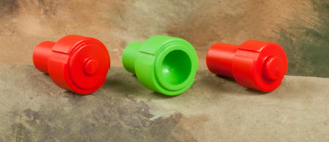

If you want to replace it, I highly recommend the followers from S&J Hardware. They offer 12ga and 20ga 870 followers with side slots that are machined from a solid piece of high-visibility Delrin acetal resin. I've worked with this polymer before, and it's ideal for this application. It's chemically stable, wear-resistant, low-friction, and wonderful for machining.
S_J Followers.PNG (202.69 KiB) Viewed 7232 times

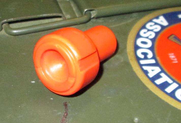

I'm not sure if they offer their 20ga followers in the dished-out Type 2 style (center follower in the above image), but even if you do have to get one with the post in the center and it catches on your carrier like your current one, the design and material makes these followers very easy to modify. I bought one of their Type 1 12ga followers (the one on the left in the above image) because I preferred the color. While it functioned flawlessly, the post had a tendency to crack open shell crimps over time, and I got tired of cleaning buffering out of my gun. A couple minutes with a half-inch drill bit fixed that minor issue, and now I'm completely happy with it.
