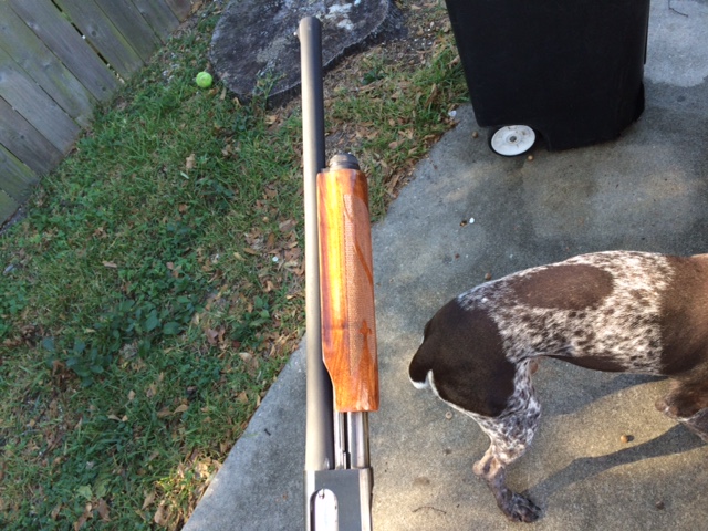

I bought a Remington 18" Parkerized, no-vent, IC barrel from Brownell's. It's nice, and looks great on my gun, but haven't been able to shoot it yet to see what brand of 00 Buck shoots the best.
870 Barrel.jpg (161.5 KiB) Viewed 3250 times
