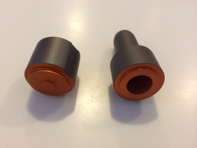

I recently received some SBE Precision followers, and I'm impressed with the quality of their products. They manufacture two models for 12 gauge 870s: a Sport/Tac model with clearance cut outs for dimpled magazine tubes, and a Tactical model with a tail. Both models are machined from 6061-T6 aluminum and anodized orange for visibility. Also, both feature a MIL-L-46010E (whatever that is) low-friction coating on the sliding surfaces.
SBE also has a 20 gauge Sport/Tac model that is Teflon coated. The Sport/Tac model has a raised bump for tactile identification, while Tactical model is counterbored. Prices are $20 for the Sport/Tac and $21 for the Tactical.

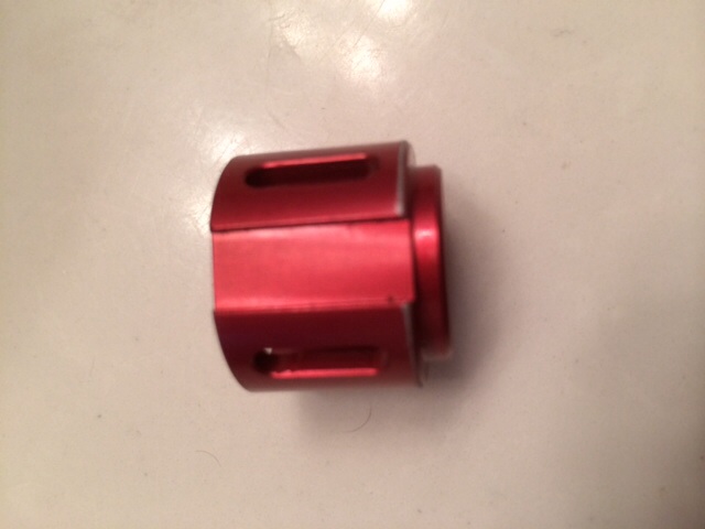

I've had good results with the Wilson's as well. I put one of the SBE Sport/Tac followers in a 25077 that has had around 1,000 rounds through it, replacing an anodized aluminum one. I just checked the old follower with my Mitutoyos, and it's pretty much cylindrical, with no discernible taper from front-to-back. I haven't compared it to the diameter of the magazine tube, but the only wear showing up is on the leading edge of the follower where it would be contacting the shells, or the stop at the mag tube end.
I guess the point being, tolerances here are not very tight, so the benefit of any anti-friction coating is probably minimized to some extent. Compared to higher tolerance situations, it would appear that the follower is sort of rattling around the magazine tube.
If you look at the attached crappy cell-phone pic, you can see where the anodizing has worn off the leading edge.
I'm not saying this is a problem, but it is an interesting wear pattern. (Well, at least to me, since I sorta geek out on this stuff.)

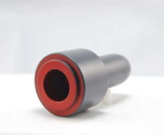

Image I gave this SBE Tactical Follower a try out of my 870P with a +3 Tac Ordnance Magazine Extension and it kept getting hung up. The follower was getting beat up too, I found that because it does not have tapered or rounded edges their is a flaw in its design. It may work for you but sadly it will not work well with my set up. Image
However I did sand the edges down myself with some 2000 grit wet sand paper and I'm going to need to test it out, I'll post back on the results.
