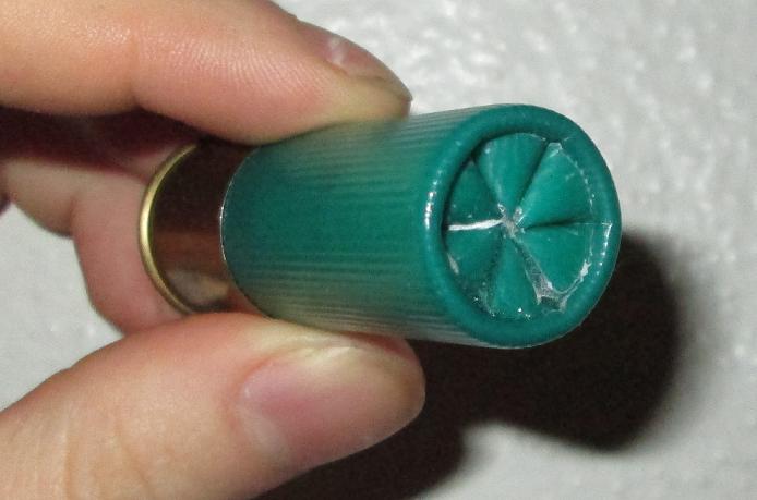

Like I said over on the blog, shotshell energetic components (powders and primers) are very similar to what's used in metallic pistol cartridges. Many powders can be used in both shotshells and pistol cartridges, and some shotgun shells use standard pistol primers. Stored properly in a dry environment, there’s no reason shotshells shouldn't have the same shelf life as handgun ammo.
Even when stored improperly, shotshells can be pretty resilient. Quality shotshells will feature things like moisture resistant hulls (plastic, metal, or treated cardboard), sealed crimps, and/or sealed primer pockets to protect the energetic components from moisture. Even lower-quality ammo can surprise you. I’ve come across unsealed plastic- and paper-hulled shotshells that spent decades in non-climate-controlled attics and garages, and every single one cycled perfectly, went bang, and thumped my shoulder nice and hard (harder than a lot of modern loads, actually).

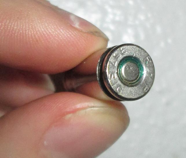

Metallic cartridges are vulnerable to moisture too. Like quality shotshells, premium rifle and pistol ammo often have features such as plated or lacquered cases, and sealed primer pockets to extend shelf life in less-than-ideal environments. Given the chance, water can penetrate crimps and primer pockets, or corrode brass and steel cases badly enough to interfere with function (something shotguns are far more tolerant of). Also, squib loads are much more of a concern with rifles and pistols than with shotguns. A metallic cartridge that didn't age well can result in an obstructed barrel, while shotguns, which run at lower pressures and have far less friction between the projectile and barrel, are more likely to just lose a chunk of muzzle velocity. Even if you do get a squib load in a shotgun, it's a lot easier to clear the barrel than if the same thing happened in a rifle or handgun.
Put a box of shotshells on a shelf next to a box of pistol rounds, and it'd be hard to say which would go bad first. You could argue that metallic cartridges have an advantage in a general sense, but it all depends on the environment, the quality of the ammo, and other factors. Personally, I think I'd be a lot more hesitant and careful about shooting old rifle or pistol ammo than old shotshells.
Sealed crimp on a Remington 12ga buckshot shell
Nickle-plated case & sealed primer pocket on a Remington handgun round
