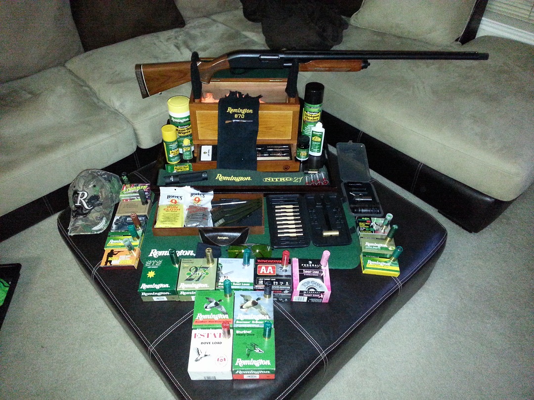

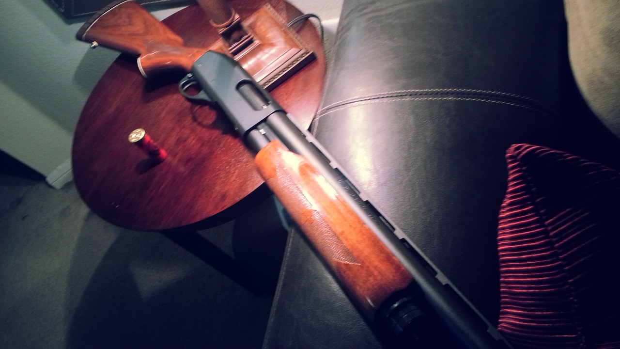

Last month I found a near mint set of Wingmaster stocks on Ebay(picture below). I really like using real walnut stocks versus the synthetic furniture. I am really glad I got the Wingmaster stocks, as they add a unique aesthetic value to the 870.

Welcome to the forum. I have to say, that Wingmaster furniture really makes the gun look great. Nothing functionally wrong with cheaper laminate or polymer of course, but nothing looks quite as classy as real hardwood.

Thanks for the reply Synchronizor! Having the Wingmaster stocks is really a nice add-on. The gloss finish and checkering is nice; but I like the walnut feel. There are a few small dings that are only noticeable if you are looking. After I do the metal finish job, I may dedicate some time to refinishing the stocks and darkening the checkering area.
