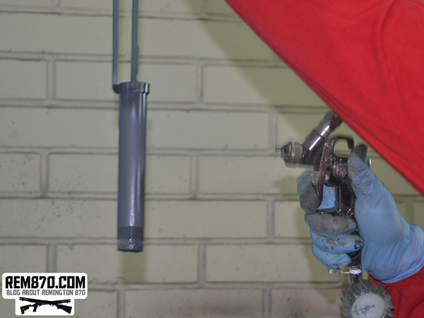

I am prepping my 870 for new duracoat finish. I just finished using it on a winchester 94 so I know how it works. I am a 1 month old 870 guy. I jumped in with both feet. I am hooked. Using the websites info I have done it up right I think. My question is when painting the reciever and mag tube. Wouldnt painting the mag tube interfear with the movement of the forend. I have checked out a bunch of pictures and it looks like everyone paints it. Just looking for some input.thanks.

Go ahead and paint it, it's gonna be ok. Here is my post: Painting Remington 870 Shotgun. I recommend using special paint on magazine tube and bolt: KG Gear Kote (Dry Film Lubricant) it made my action as smooth as possible.
I'd love to see photos of the process and ready result.

The fore-end tube is not a super-tight fit on the magazine tube, so you should be fine, especially if you do the proper surface prep first.
