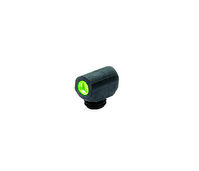

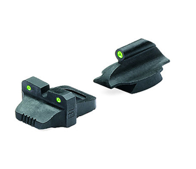

Meprolight make two options for the 870 but there are plenty of other options available.
- For 870 Slug Guns
- ML_34660b.jpg (42.68 KiB) Viewed 6269 times
- Direct Replacement for 870 Bead
- ML_34045b.jpg (24.19 KiB) Viewed 6269 times
