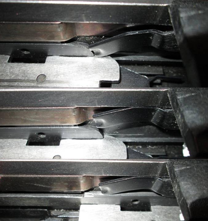

It sounds like your action bar lock or action bar is worn or damaged enough for the lockup to fail when you twist the fore-end. If you push your shell carrier up, you can see the point where those two parts interact. Try instigating the problem while looking at that spot. Hopefully you can get a better idea of what's going wrong.
Here are some images of the action bar and action bar lock on my 870. I removed the shell carrier for the pictures, but you can see them well enough by pushing the carrier up.
Top to bottom: action locked, action unlocked, action open

Thank you, that picture helps a great deal.
I am able to look in with the shell carrier lifted and see the parts engage with each other. If there's wear or damage, my eyes aren't yet trained enough to see it.
If I press the slide release, the action bar lock lifts up, clears the action bar, and allows the action to slide open, as normal.
If I twist just a little bit on the vertical foregrip, I can see the action bar flex to where it is just barely engaging the action bar lock. If I then jiggle the slide just a bit, the two pieces disengage. The action bar lock does not lift, but the action bar slides around it. Thus, when the slide is about halfway down, the action bar jams against the action bar lock, preventing the slide from opening further.
Now that I can see what is happening, what can I do to fix it?
