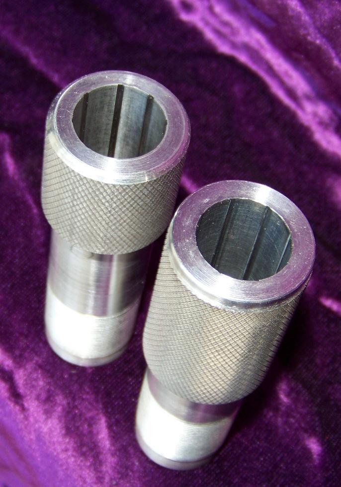

I have a rifled choke tube that was thrown in with a barrel I purchased, but I've never gotten around to shooting anything through it. I don't expect just an inch or two of rifling to do much to any type of slug, especially considering their mass and wildly-varying dimensions.
Rifled Choke Tube_small.JPG (48.72 KiB) Viewed 9198 times
However, rifled choke tubes can also be used with shot to produce a very wide (if sometimes inconsistent) pattern. The helical rifling imparts spin on the wad and/or some of the shot column, making it spread more rapidly when it leaves the barrel. Some rifled chokes are specifically marketed for this, and called diffusion chokes.

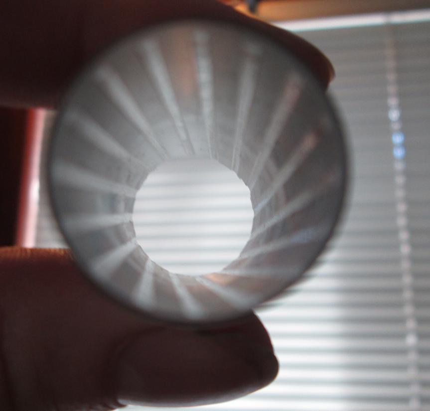

Other rifled chokes are designed to have the opposite effect on shot, and instead of helical rifling, use straight rifling to try to cancel any spin the shot or projectile may have.
