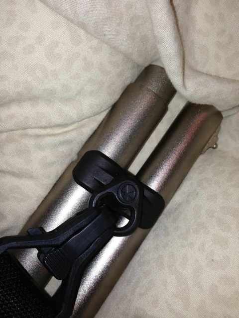

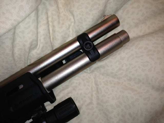

In surprised no one has mentioned the Magpul sling mount/barrel clamp. I absolutely love this setup with my SGA Stock, SGA sling mount, and MS3 (multi-mission) sling. Only time I switch it out is if I put on the Hogue "Tamar" Pistol Grip, then It suites me to reinstall the Remington clamp that has the same sling mount that works with my stock Marine Magnum Remington sling.
JBall
Posts: 185
Location: Upstate New York
Magazine Extensions for Remington 870
Post by JBall »
Here are a few shots off my stock Remington +2 extension with Magpul barrel clamp/sling mount...
