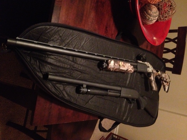

Top: 870 Express 28" barrel with extra full turkey choke Bushnell red dot Black hawk! knoxx camo furniture.
Bottom: 870 Express magnum 18" security barrel black synthetic stock

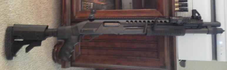

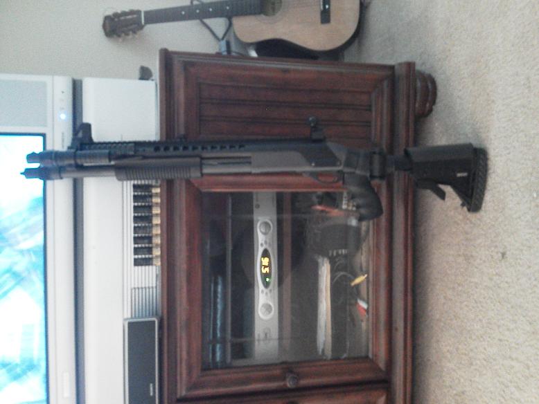

Here's my Rem870. It has the following listed below.
1. ATI strike-force collapsible and folding stock with forend. Could not use the forend because the adapter would not stop the forend from binding against the slide-stop. Should not have purchased the collapsible stock as my large hand feels squashed against the folding point. Will either purchase an ATI grip that eliminates the folding point or go with a Magpul buttstock once I have the opportunity to hold one and rule it in or out.
2. AimTech Warhammer rail
3. Tuff-Zone AR-15 flip-up rear sight
4. Leapers UTG AR-15 low profile front sight
5. Wilson Combat - Plus-One magazine extension Comes with new spring and high visibility follower - You have to drill out the dimples in the magazine tube that secured the old spring retainer and carefully grind down the raised metal in the magazine tube with a barrel stone with a dremel in order to get the new follower in the tube.
6. Cross-Point Green Laser with pressure switch The pressure switch works flawlessly; however, the push button cap for some reason does not seat properly and does not always turn on. Easy to zero to the sights. Will now have to zero sights to barrel and re-adjust.
7. Sight-Mark 260 Lumens Weapons Light with pressure switch $79.99 - Do not look directly into light when fiddling with the pressure switch if it is your first time ever having a do-hicky like this one has. Still have a slight headache 12 hours later.
I have put it through the paces at the range. It is very heavy for prolonged shooting. Was considering the Magpul forend and then adding a vertical grip; however, the Magpul forend will not work with my rail without modifying it (I'll pass). Might consider another forend that will allow me to add a vertical grip; but, I don't want to invest anymore money unless I know it is something I will like. Hope to find someone in the Tampa, FL area with some other accessories that I could either test shooting his/hers or test on mine and determine if I want it. So, to complete it, will look for a nice muzzle break, either get another grip that removes the folding point or get a Magpul stock with adjustable LOP (I think it looks cool and looks like it points well).
