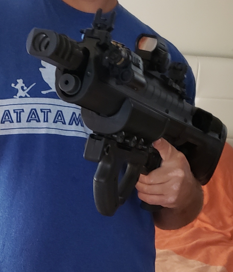

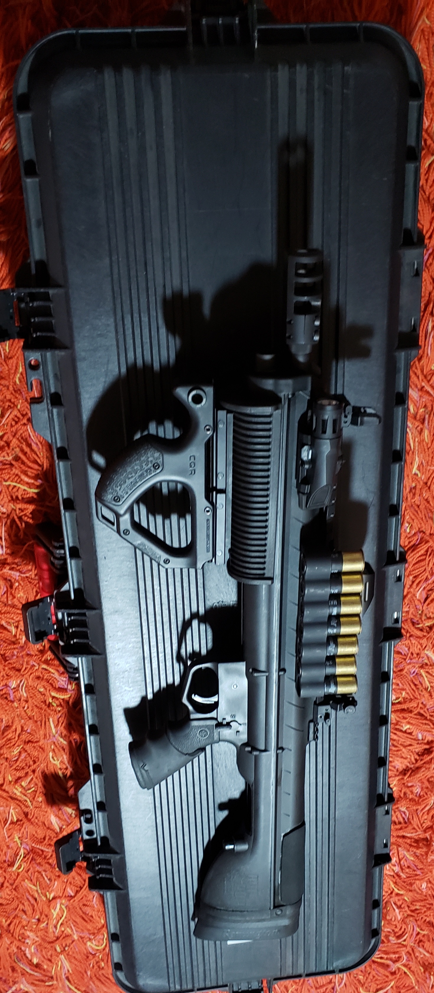

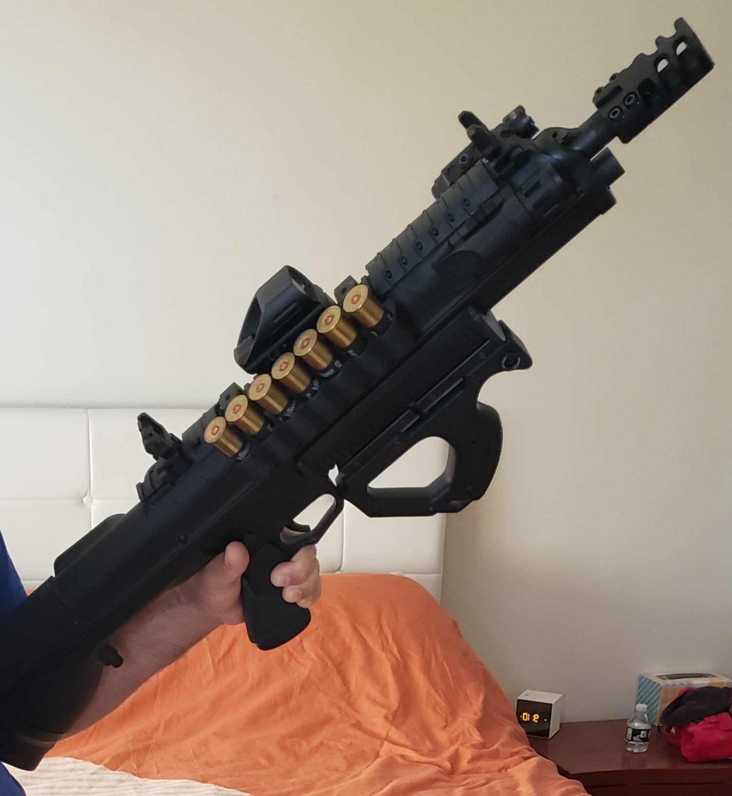

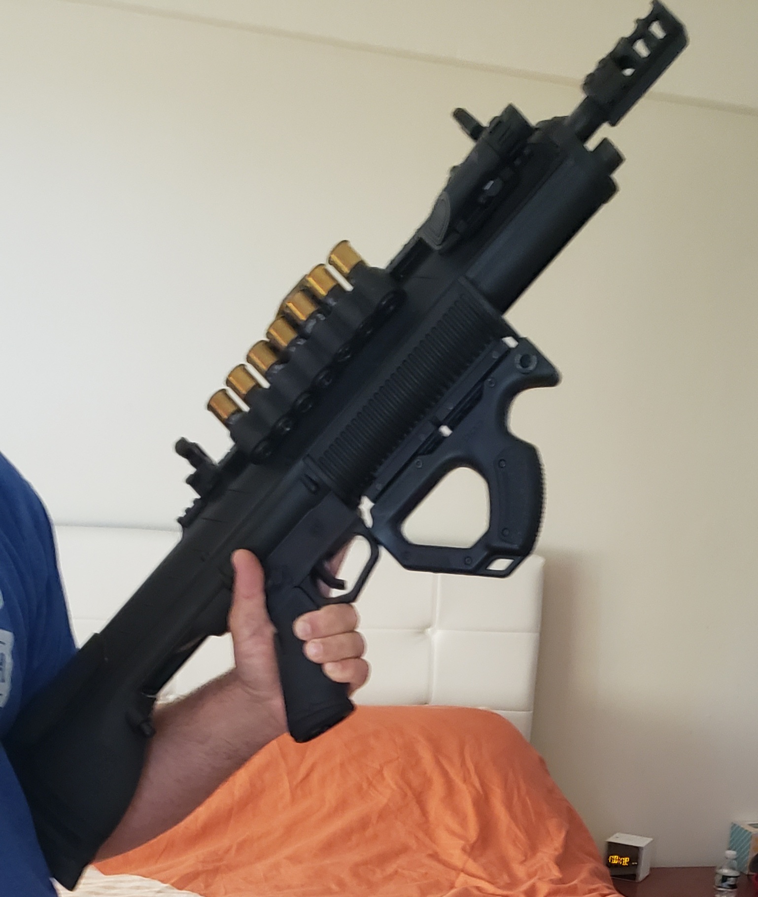

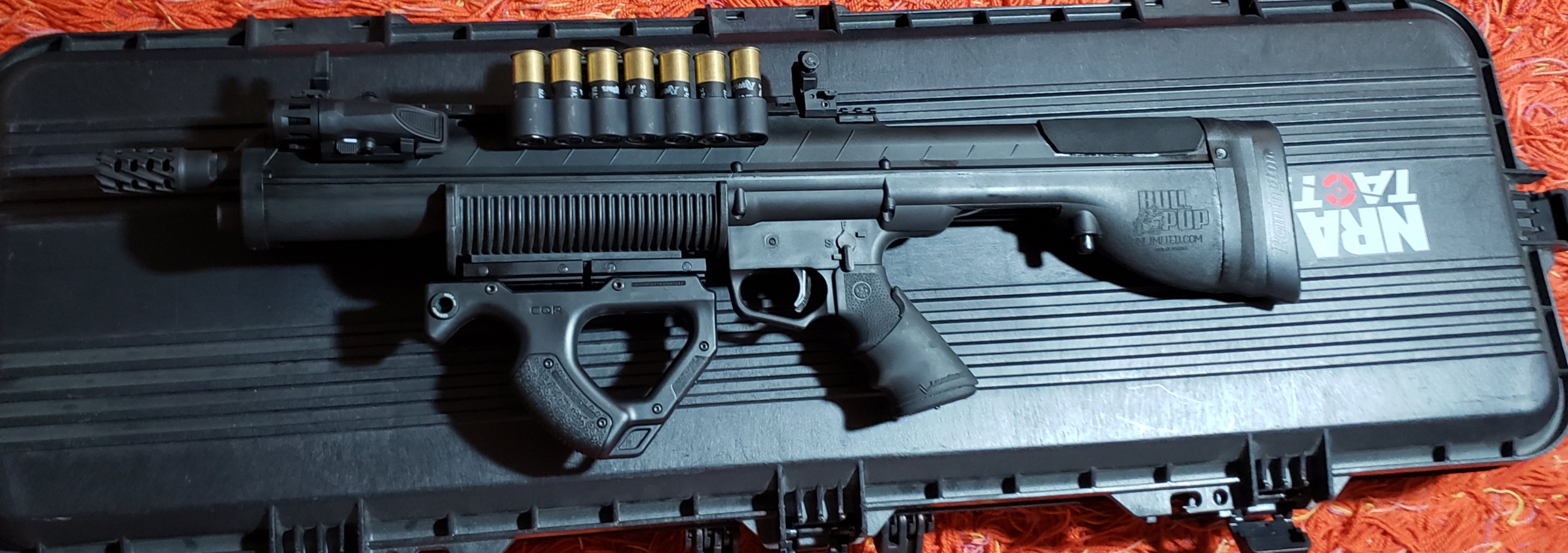

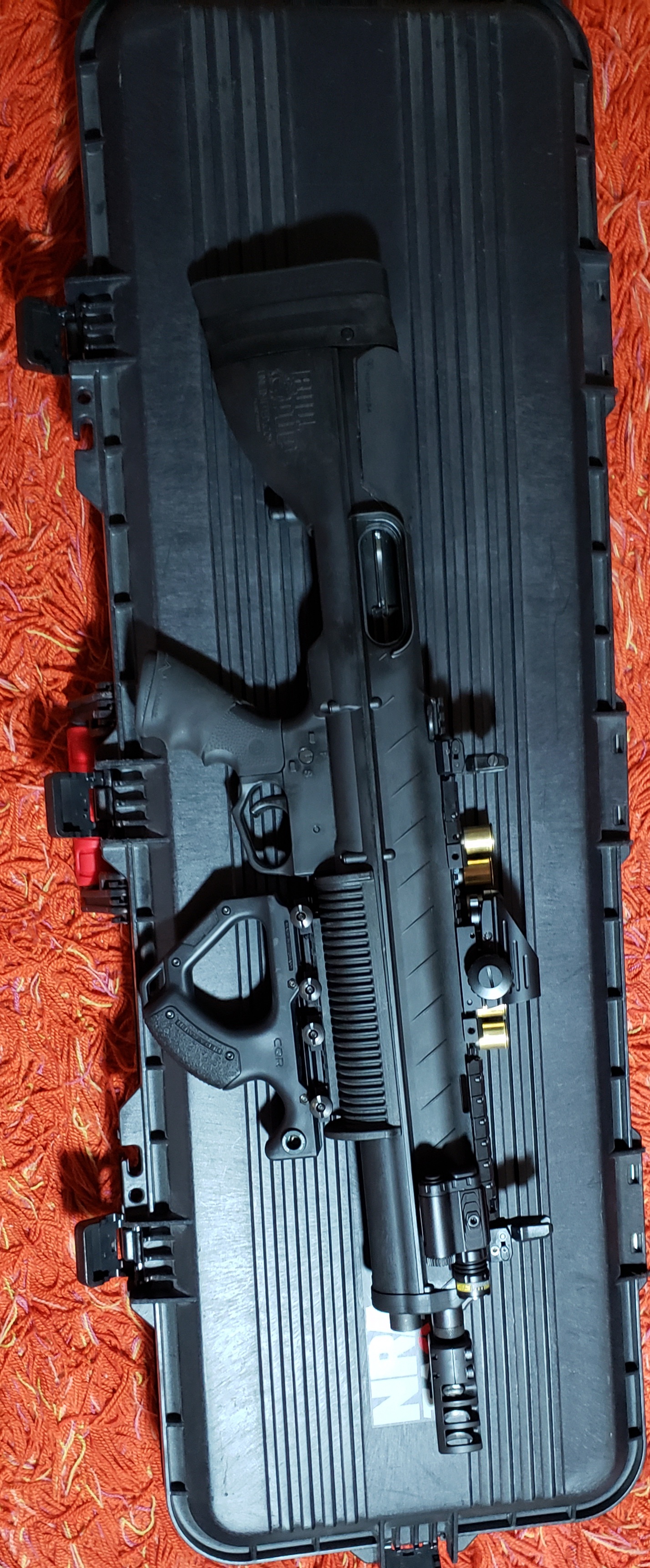

Remington 870 bullpop conversion.

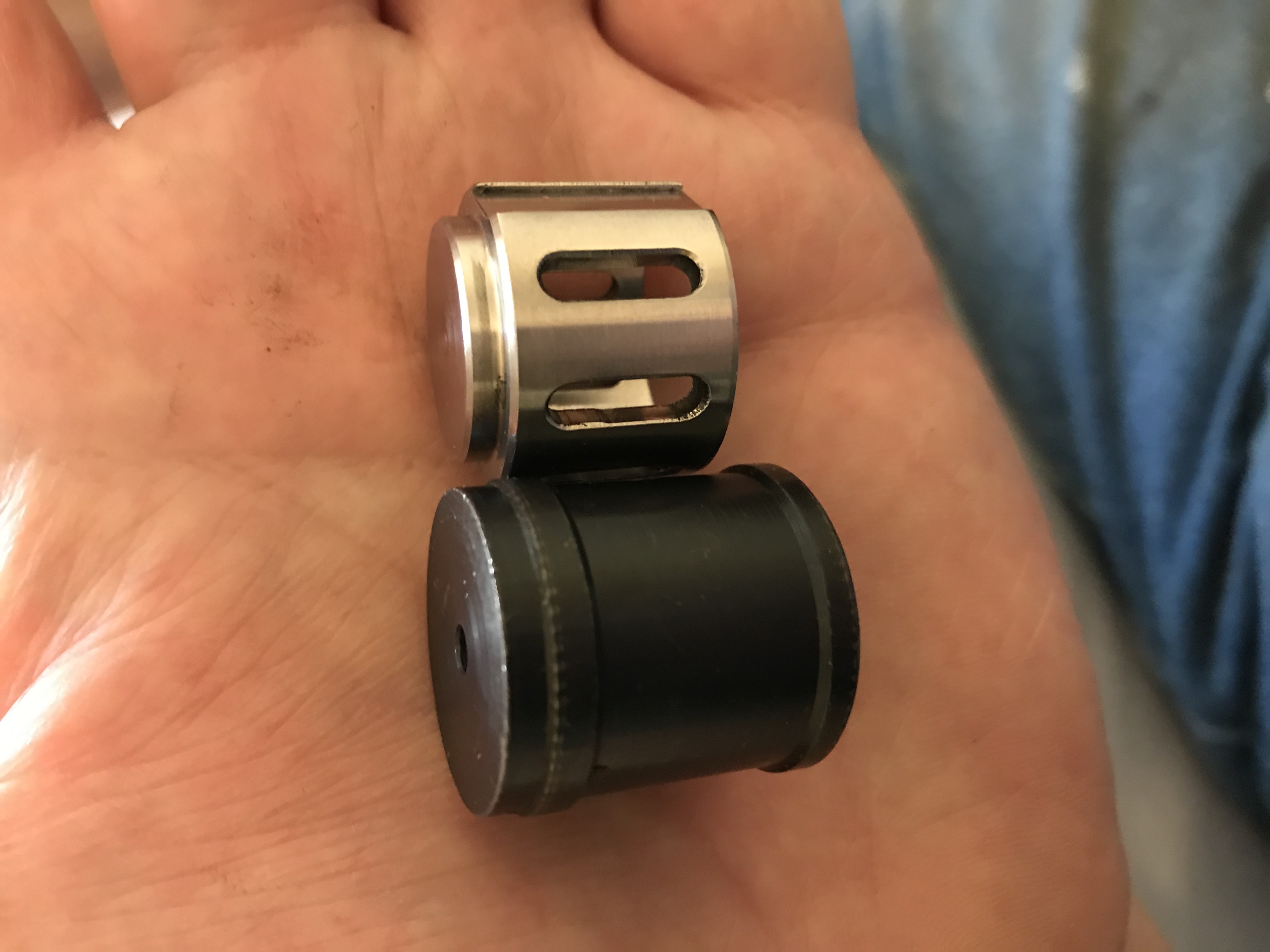

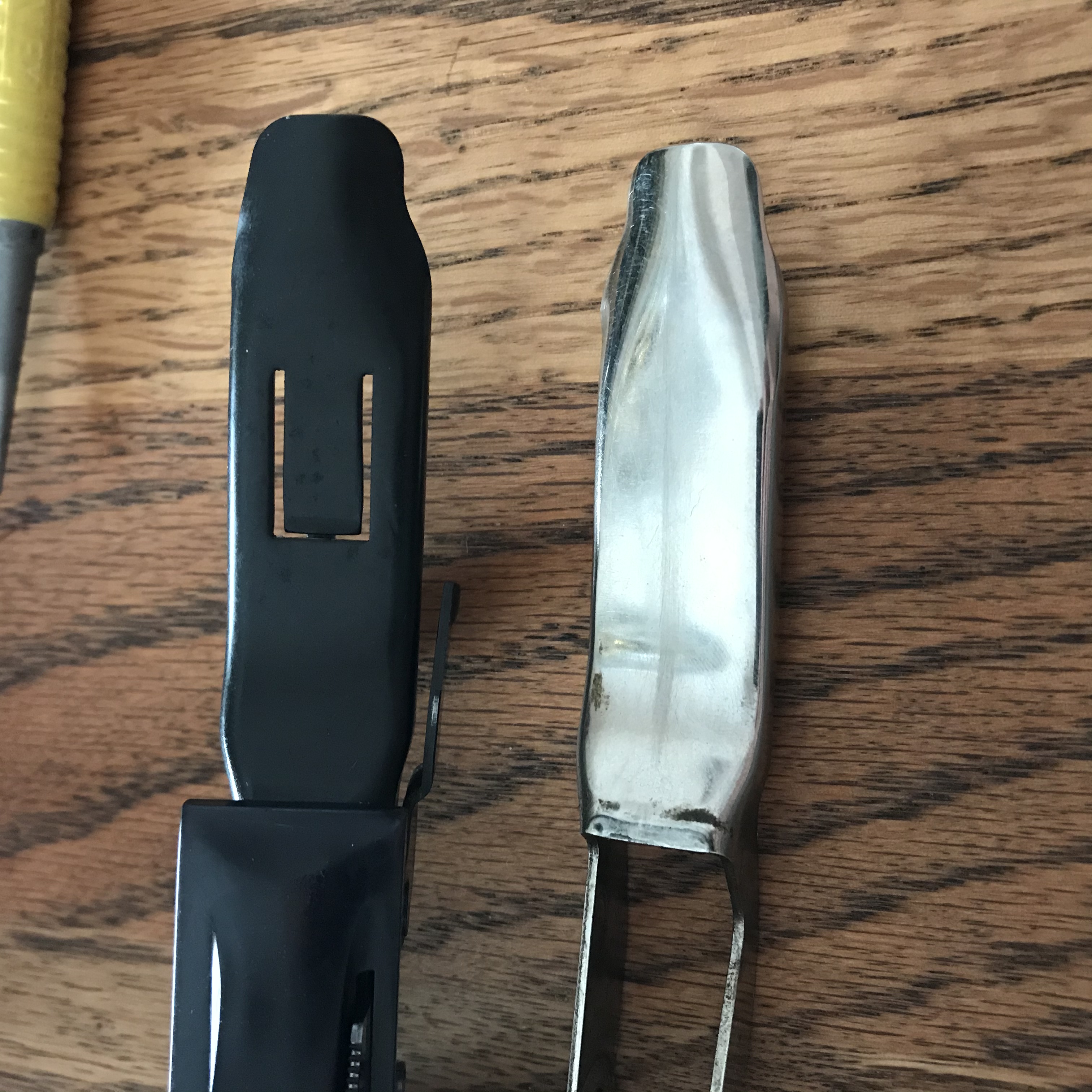

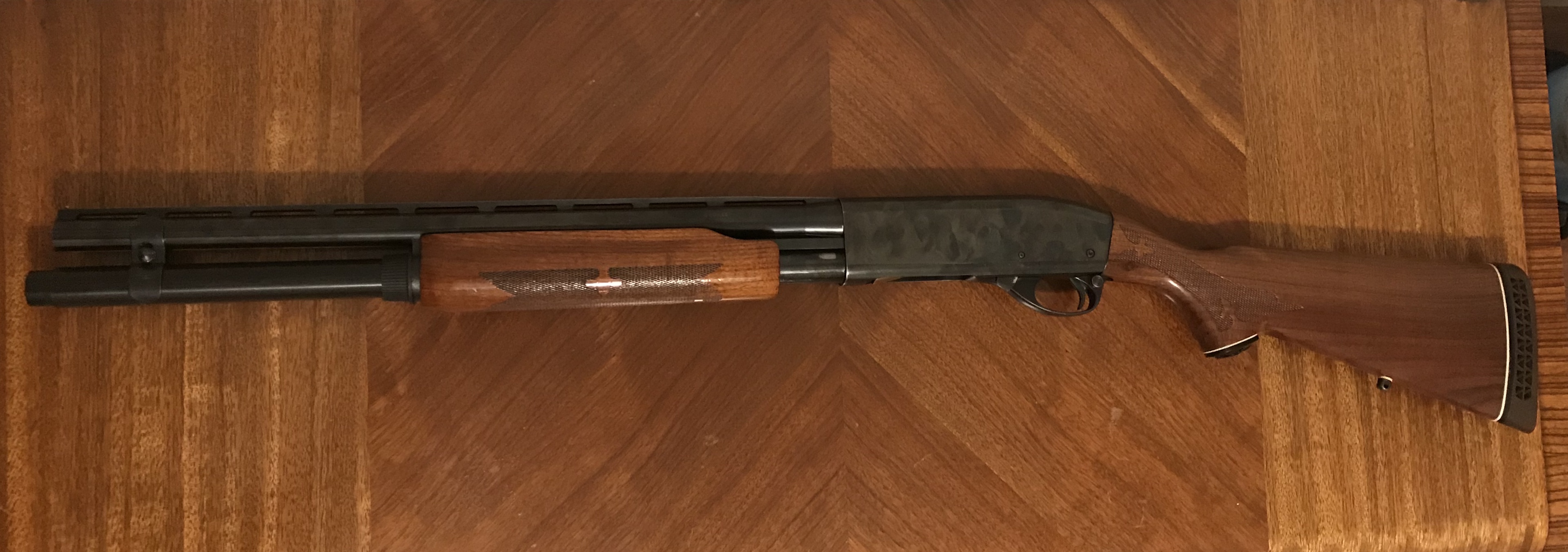

A work in progress.
Basic HD setup As I like it’s looks.
1975 Wingmaster 12ga, 20” barrel, Plus 3 Mag Extension.
Recently tuned up and minor repairs done by gun smith.
Just added:
Finally added a Brownells Stainless Steel Follower (which I polished off any sharp edges), a Wilson Combat Jumbo Safety and a updated Remington Shell Lifter (slotted type) though sadly not a chromed one.
Still debating if I want a light or which light to use.
I also found a place near me where I might be able to do some trap shooting so I can do some test firing and get some practice in.

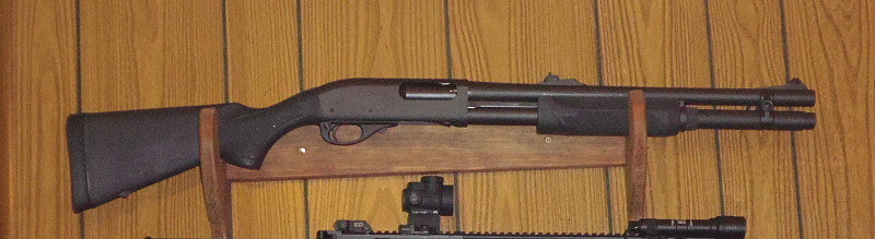

This is my new 870, It's pretty basic at this point but have big plans on upgrading and customizing it.

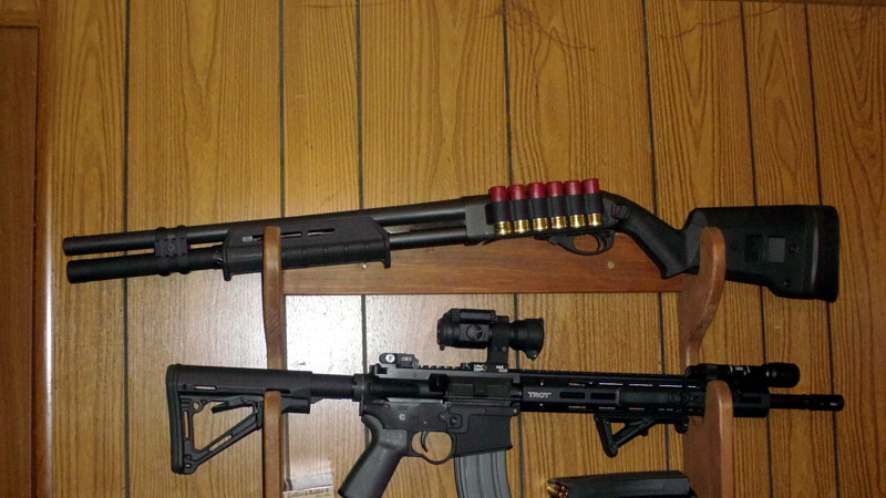

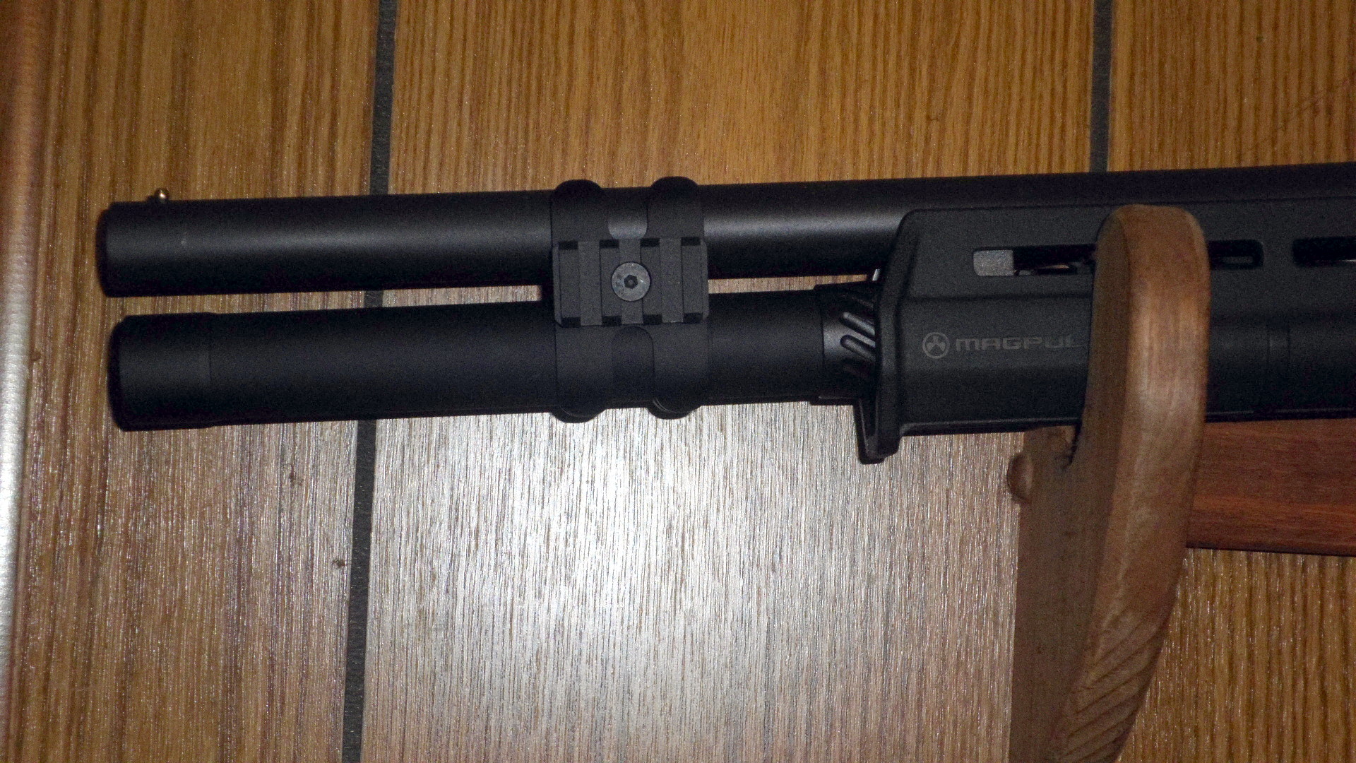

This is my Rem 870 with my new Nordic +3 mag extension and 20" barrel. Magpul furniture and a Mesa tactical 6 rd Sidesaddle.
Rem Nordic.JPG (112.04 KiB) Viewed 48833 times
Rem 870 Nordic.JPG (769.51 KiB) Viewed 48833 times
ChillyB
Posts: 178
Post by ChillyB »
Been eyeballing those Nordic mag clamps. Any regrets or issues with fit?
If I may offer a suggestion I'd move that clamp further toward the muzzle. I think most likely mag failure is hitting end of mag on something and folding the permanent tube at the threads. Moving further forward gives max rigidity by minimizing the unsupported portion hanging out in the breeze.
USAF Shooter
Posts: 52
Location: Michigan
Post by USAF Shooter »
I really like Nordic mag tube extensions, and clamps. I actually prefer them to Remington, Wilson etc. I put the Clamp where it is b/c I am going to mount my Streamlight Protac Flashlight on it, and I wanrt to be able to activate the tailcap button easily. BTW, the fit and function is amazing.
ChillyB
Posts: 178
Post by ChillyB »

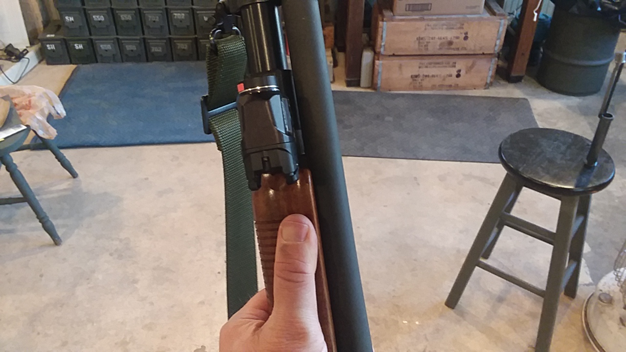

Ah. I see. I have Remmy tube and clamp with streamlight TLR-7A pistol light right up against forearm on a streamlight tube mount. The pistol light actuation button is right where I want it.
