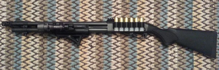

Post by goneWylde88 »
As it sits now...next up is the Mesa Tactical Urbino stock. I don't like where the light is mounted either, but it's the only available rail at the moment. Eventually, I'd like to get a magazine tube clamp with optional 5 slot rail to mount the light to.

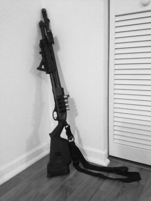

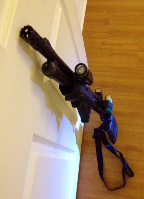

Just finished my build. Started with a wood stock 870 Express with a 28in barrel.
Added:
Magpul SGA Stock
Magpul foregrip
Sage +2 mag extension
L&M flashlight mount
GG&G follower
Punisher trigger assembly pin
Cut the barrel down to 18.5
Posts: 1273
baggedcobra, nice setup! Have you tested the flashlight mount? Does it stays in place under recoil?

Post by baggedcobra »
Vitaly wrote:baggedcobra, nice setup! Have you tested the flashlight mount? Does it stays in place under recoil?
Thanks buddy. I've not had the chance to shoot it yet. I literally just finished the build yesterday and the flashlight mount was pretty much the last thing to go on the gun. So far I love it.

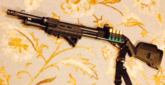

Here is my build from the UK, Its an old 870 wingmaster with non vented barrel and metal trigger housing
24" ported barrel
Magpul furniture
Nordic + 5 extension
I silver soldered the LPA front sight on and milled the holes on the receiver myself and had the whole gun cerakoted

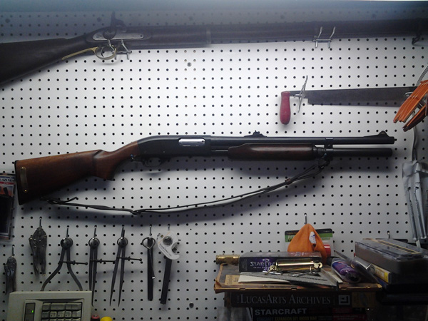

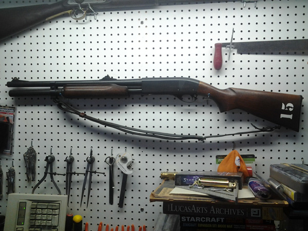

More of a restoration than a build... I picked this old 870 Wingmaster riot gun up at a West Virginia pawn shop a couple years ago for $125. Even though it had the finish all worn off, one sling swivel missing, the other one broken and the stock beat up and cracked, it still looked like it had some life left in it.
I had the metal re-Parkerized by Knox Metal Refinishing of Marietta, Ohio. I replaced the broken stock with one of the same vintage style found on Ebay. It was cleaned with alcohol to remove all the built-up grease and crud, the dents and scuffs steamed out, sanded, and refinished with several applications of boiled linseed oil. The sloppily stenciled rack number on the original was duplicated on the replacement stock, the property tag polished and the skull-cracking curved aluminum buttplate repainted. The missing/broken sling swivels were replaced with a pair of Uncle Mike's detachable swivels and an older black leather military sling added. A few applications of Johnson's paste wax on the stock finished the job.

Reeeally nice job on that one. I love the look of the old Police guns. Nicely done.
How's she shoot?
wljphott
Joined: Wed Dec 25, 2013 1:55 am
Post by wljphott »
Thanks. Shoots as expected with 00 buckshot and no choke. It will be a fine home defense gun and a good conversation piece.
