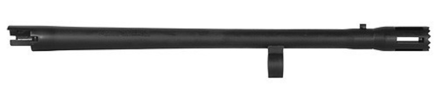

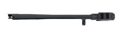

I have a cylinder bore barrel, so I'm assuming that I can't use a threaded choke or adapter without some gunsmithing.
As far as the muzzle brake goes, yes I know it's going to be only for looks. I'd rather have the "suppressor" looking one than the .50 cal-style one. I'd even settle for the breach barrel. The problem is the description for each barrel says it is 18.5". Is that 18.5" overall, or is 18.5" to the rear of the brake, which would make that actual overall barrel length around 22" to 23"?
With the quad rail that I have installed, it leaves me with 1 1/4" of the barrel sticking out past the rail.
Here are a few pics so you can see what I'm talking about:
Rolling Thunder.jpg (6.94 KiB) Viewed 12345 times
Road Blocker.jpg (6.06 KiB) Viewed 12345 times

The first two barrels you linked are Mossberg barrels, so I'm not sure on those. For this one though:
A quick calculation based on the location of the barrel guide ring shows it's 18.5" overall, from the breechface to the end of the stand-off. If all you're after is a muzzle device, you may be able to have your current barrel threaded and buy a Remington breaching choke for less than a brand-new barrel would cost.

The first two barrels that I posted are made by Mossberg for Remington 870 shotguns. The location of the barrel ring guide looks suspect on those as well.
I'd probably better e-mail them to see what the exact dimensions of those barrels are. I might just be better off having the barrel threaded and use the Remington breach choke that you posted.

I can tell you that the first two are Mossberg 500-series barrels; they have the Mossberg-style barrel lugs, and cut-outs for the dual extractors. If someone's calling these Remington 870 barrels, they're wrong.
The third is definitely an 870 barrel though; pass-through barrel guide ring, single extractor notch on the right side, and an 870 locking notch in the barrel extension.

Thank you for the information. I hadn't noticed the differences. I'm sure that the various retailers that I've found these barrels on just posted a generic picture of the 500-series barrel. Even so, I'm going to e-mail Mossberg to make sure.
