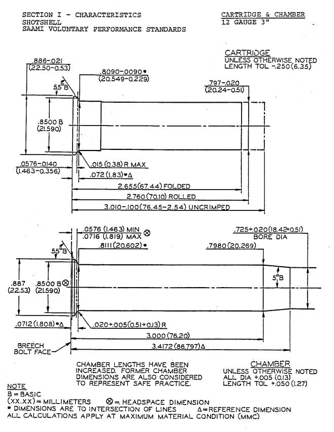

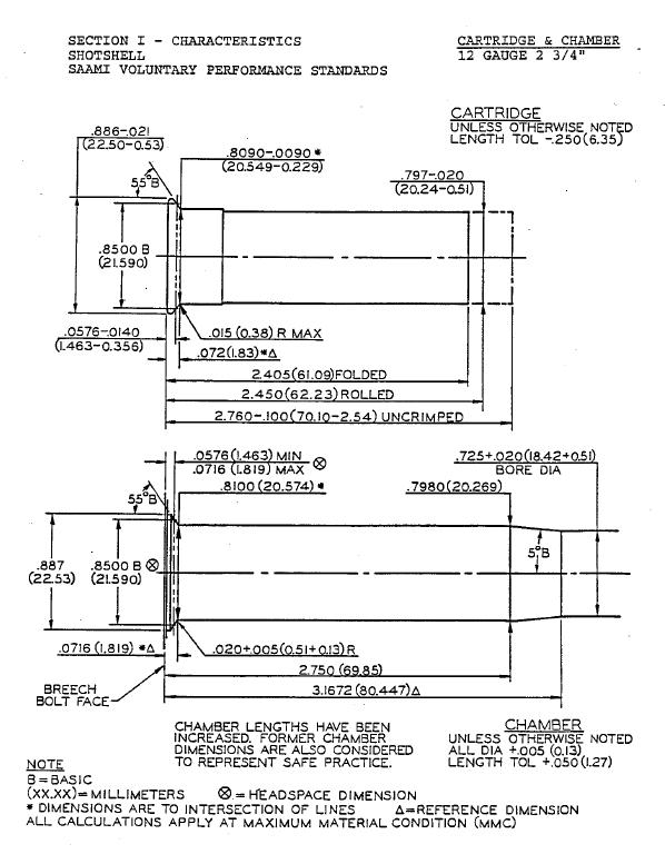

The mini-shells I'm thinking of are more like these:
These are advertised as being 2.25" 12ga shells. If that's their unfolded length (which is the standard definition for shell length), then their fold crimps should make them at least .35" shorter in their unfired state. That's starting to get short enough to cause feed malfunctions in an 870, especially if you're cycling it slowly. It should do well enough for recreational shooting if you remember to rack the gun quickly, but for critical roles, I wouldn't depend on anything less than 100% feed reliability.
If you want an extra round and reliable feeding, fold-crimped 2.5" shotshells should let you fit 5 rounds in a 4+1 870 magazine (though you may have to take out the spring retainer and/or change the spring). 2.5" chambers weren't uncommon in older 12ga shotguns, especially over in Europe where 2.5" 12ga shells were the norm, and the 2.75" and 3" shells were for heavy loads (American manufacturers have long favored full fold-crimping over rolling or partial crimping, and so preferred longer 2.75" minimum hull and chamber lengths). 2.5" (or 65mm, as it's usually referred to across the pond) 12ga ammunition is still loaded and sold alongside the 2.75" and 3" stuff by companies like Eley, Hull Cartridge, and Gamebore in the UK. The trouble is, these 65mm shells are usually bird or clay loads. It'll probably be tough to find good defensive loads like 00 buckshot ("SG" shot to the British, if my tenuous knowledge of European shot sizes can be trusted). If any other members here know of a company that sells 2.5" buckshot, I'd love to hear about it. A reloader can always cut a hull down to 2.5" of course, but there's added legal liability involved in using handloads for self-defense outside of SHTF/WROL/extensive social collapse.
