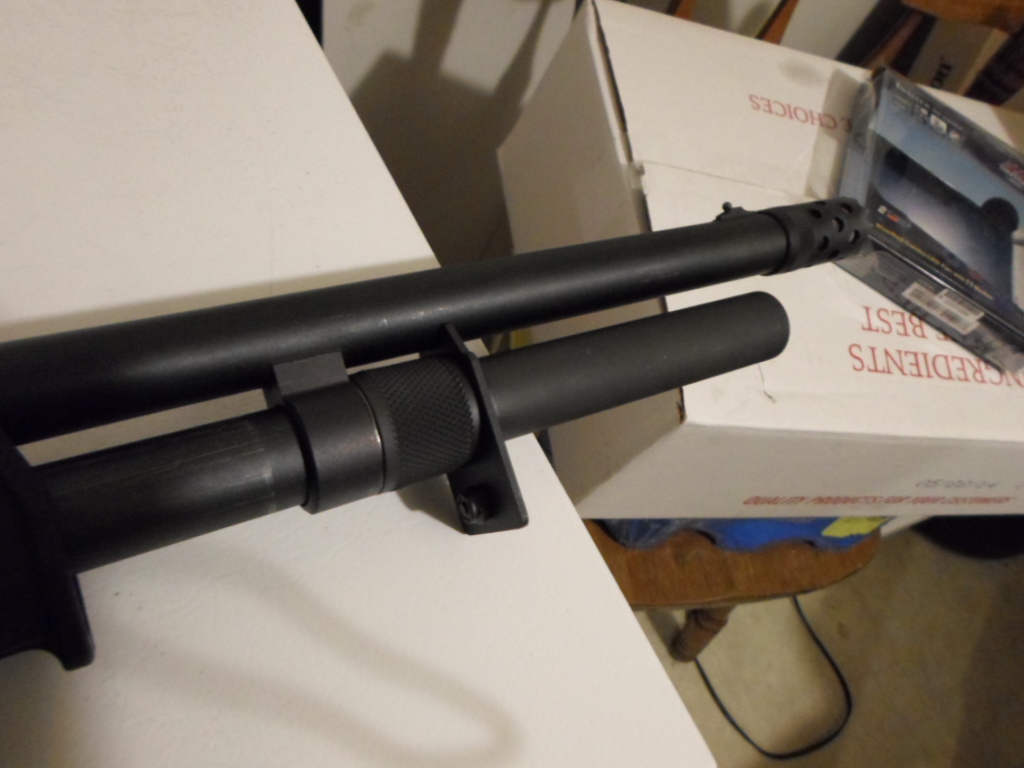

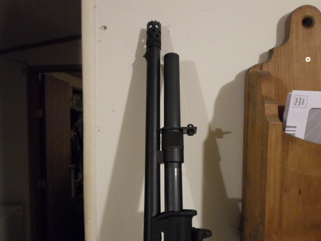

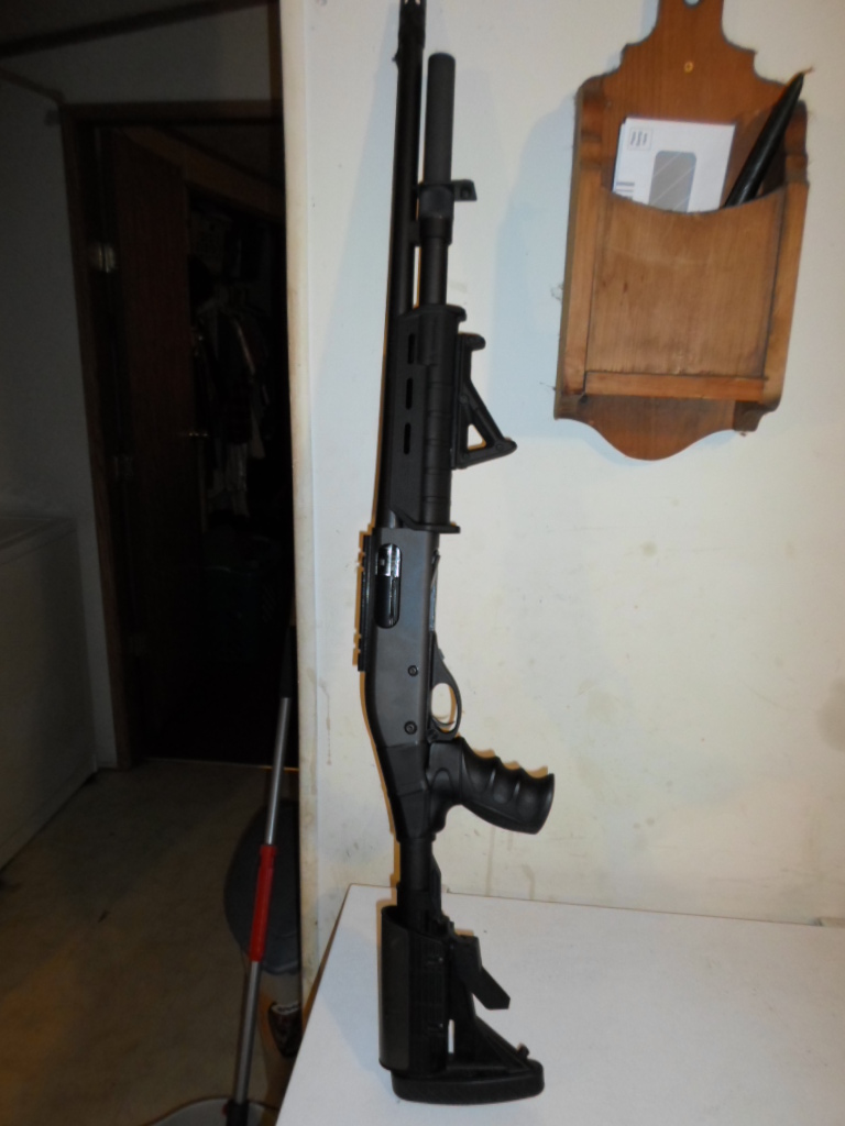

Here are some pics of my 870 with the new Scatter gun Tech mag tube extension. I shot about 50 shells through it the other day at the range and about 21 shells into it I could not load all 6 into the tube. I was wondering if it could be my follower because it did the same thing in the Remington Mag kit I did have installed on it.
Do I need to use a pair of pliers to tighten it on there correctly or is it the GG&G follower (see pics above).
I have tried everything with the Remington Kit and gave up and got the Scatter GUN Tech by Wilson Combat. Now after being on the range and it messed up I am at my wits end with these mag tube extension kits.

I like and only use the S & J plastic followers in my 870's, and have never had a problem. I also use 1 piece extensions on my guns, Tac Star and ATI.
Have you not tried the Wilson Combat plastic follower that came with your extension? If it hangs up too, you may have problems with the mag tube. Did the 2-piece Rem extension booger up the end of your mag tube maybe? Check it for out of round or a burr on the end. Maybe you could try the extension without the wave washer if your using it. Just throwing out some ideas to maybe help you.
Re: Magazine Extensions for Remington 870
I tried the green follower that came with the Scatter gun kit and it worked, I did not get any hangups, there where a few times it did feel like it wanted to hang up but did not. I was not sure you could install it without the wave washer, I will try that if I do start getting issues again. Thank you for your replies
I believe the wave washer is only needed if your barrel does not have the ball detent. Glad to hear your 870 is feeding rounds properly now.
