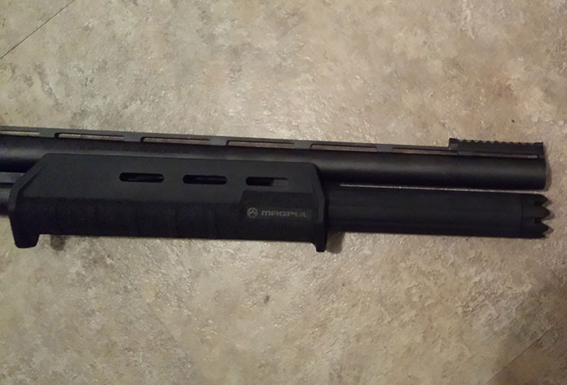

I've just installed a Wilson combat +2 and work perfect and looks good only $45 on there site really works well for the price and quality can't beat it.ImageImage

The Wilson extensions are a good bang for the buck, and don't need to be clamped since they're single-piece extensions (though it still wouldn't be a bad idea to clamp +2 or longer extensions if this is going to be a serious defensive gun). If you want something modular, two-piece extensions like the Remington or Nordic kits are more flexible since you can change just the tube to get various capacities. Nordic extensions are aluminum, while the Remington ones are steel, and have an end cap that accepts M16 bayonets if you also install a bayonet lug (not terribly useful, but pretty cool).
