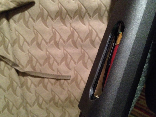

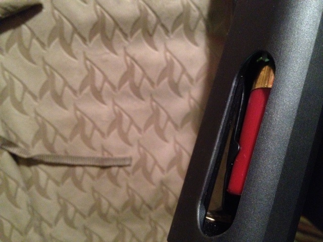

Synchronizer, haha that's embarrassing, I just usually have 2 3/4". Okay so loaded up some 2 3/4" and it went smoother but not consistent. Here is what happens when it Fs up. You can kind of see it but the shell gets angled a bit before going into chamber and gets stuck as shown it bottom pic. Detailed pics of extractor next.

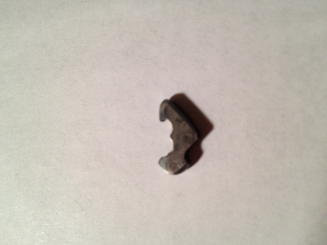

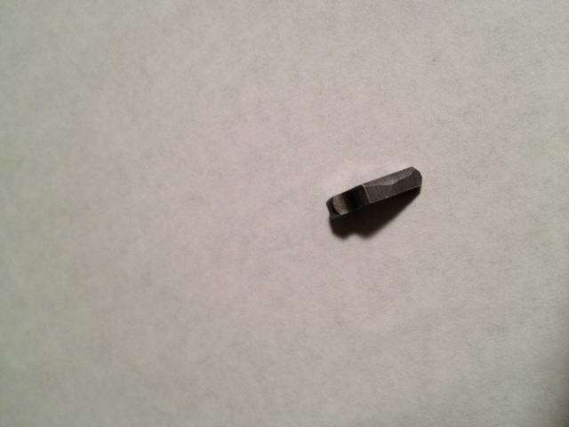

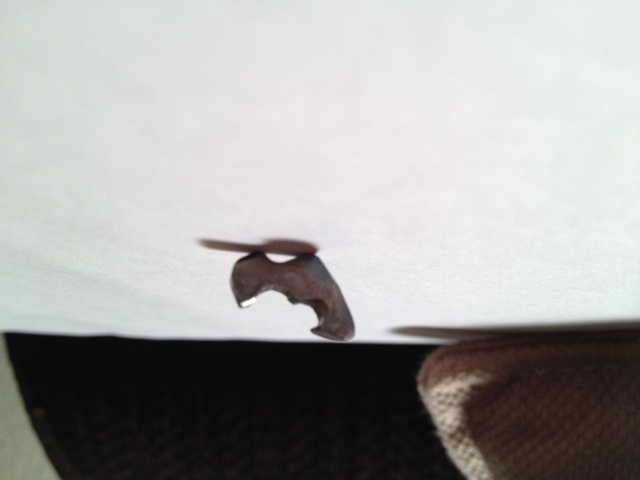

Close ups (iPhone pics)

Best I can tell, that looks more like an 870/1100 extractor than an 11-87 extractor, but it still could have some dimensional issues.
Here's my guess at what's happening; let me know if I'm wrong.
When the carrier brings the shell up and the extractor tries to attach before it's parallel with the chamber, the extractor isn't pushed out of the way easily enough, so the top edge of the angled shell is pushed along the top of the inside of the receiver, where it snags on the lip above the chamber. Since a 3" shell is longer, it's less likely to be lined up before the extractor encounters the rim, making it more prone to hanging up.
If you open your action all the way, drop a shell into the ejection port, push up the shell carrier with your finger so the entire shell is held against the receiver parallel to the barrel, and then close the action, can you replicate the jam?

Ok heres me swingin for the fence. I looked at mine. The shell is angled the exact same as yours. theres nothing for the shell to snag on. BUT if your follower got bent one way or the other side to side some how then it would snag the edge of the chamber.
Also pump shotguns are very rough if the action is worked slowly. Im assuming its hanging up at full speed but i have to make sure your not creating this just by working the action slowly.
