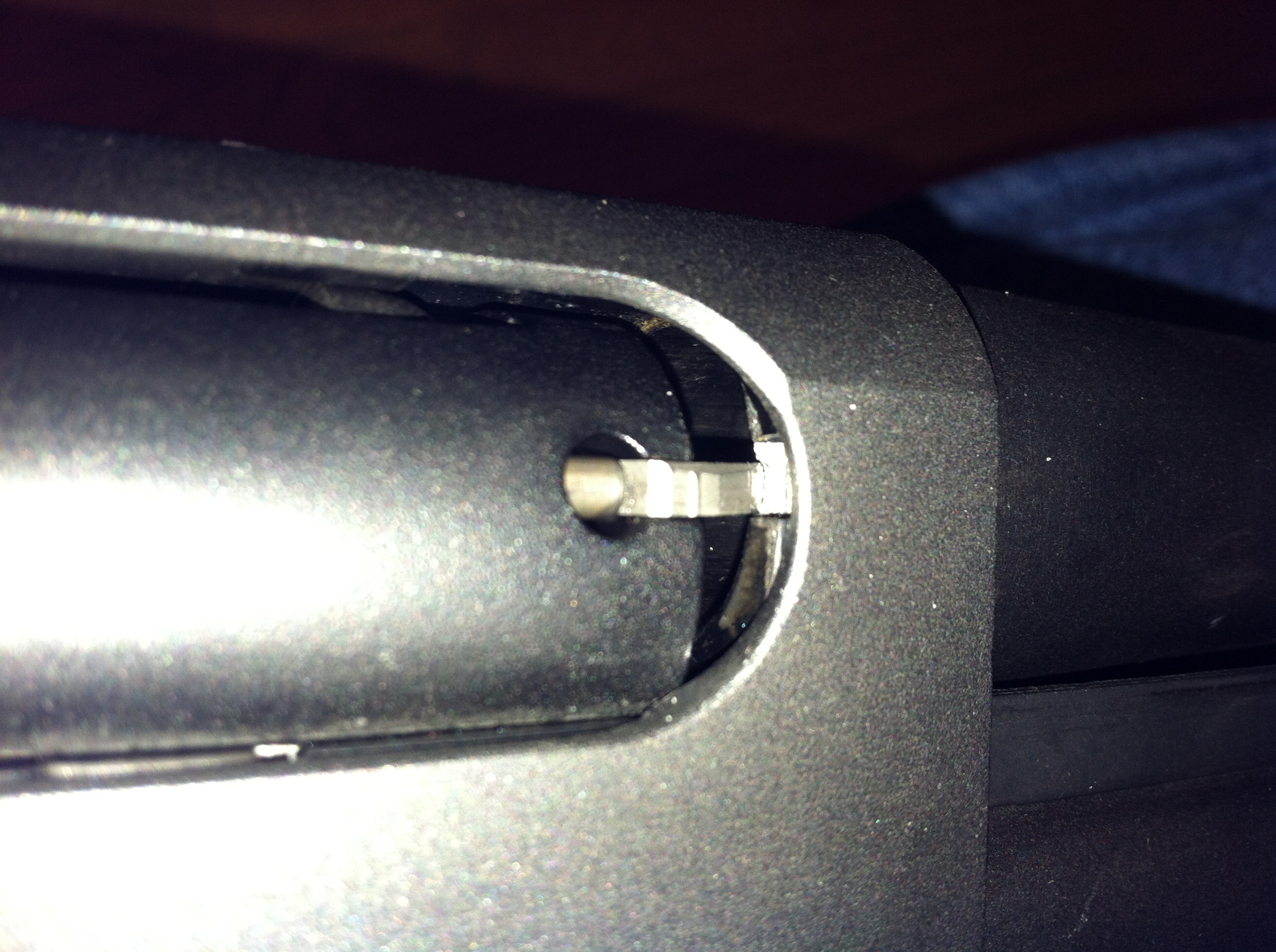

Extractor hitting barrel, will not go into battery

I've decided to use 2-3/4" shells with #4 shot (turkey loads). If I ever need to fire this gun in defense it will undoubtedly be at very close range, firing from the hip. I've watched videos on utube of shooters firing one of these holding it only by the pistol grip with their right arm almost fully extended. I need both arms just to hold the gun horizontal. The photo is the extractor hitting the barrel. Gun goes in for repair this week.

Re: Extractor hitting barrel, will not go into battery
Baby Gary wrote:I've decided to use 2-3/4" shells with #4 shot (turkey loads). If I ever need to fire this gun in defense it will undoubtedly be at very close range, firing from the hip.
You might want to rethink turkey loads for HD. They'll do more damage than something like #7 target loads, but #4 shot is still pretty small (nominally .13" in diameter; for comparison, #7 is .1") and will have limited penetration. Turkey shells (even 2.75" shells) also tend to be loaded pretty hot & heavy, giving them more recoil than combat buckshot loads.
You'll also definitely want to aim your shotgun. Shooting accurately from the hip is difficult enough at the best of times, and the stress of a real shooting doesn't help matters. If you need a short overall length for storage purposes, a folding stock will accomplish this, but still let you aim properly when shooting.
Back on topic though; as far as I can tell from the picture, there don't seem to be any major alignment problems with the barrel, bolt, or receiver. My guess would be that due to either a defective or damaged extractor, or an improperly-machined extractor notch in the barrel, the extractor was just barely clearing the notch when you first got the gun (which is why it passed function tests and worked well enough the first time you shot it). Then, for some reason, the barrel and/or extractor shifted just enough for the tip of the extractor to slip underneath the extractor notch. Once that happened, the extractor notch was damaged and the extractor would get jammed underneath it every time (kind of like how you keep biting the inside of your cheek after you bite it hard the first time). If this is the case, Remington should be able to just drop in a new barrel and extractor and solve the problem.
Like you said, it's very important to thoroughly inspect and test any gun you intend to rely on. The 870 is a great design, and most of them don't have any issues - especially once they're properly broken in - but even the best production operations will see some defects, it's a statistical certainty.

Happy to say, gun has come back with new barrel and new extractor. Quick service from Remington. Looking forward to shooting a couple of boxes of shells.
