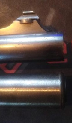

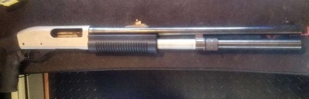

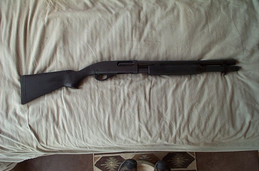

It is impossible to add 3 rounds to an 18" barrel and be flush. Simple math dictates that, and no amount of advertising spin changes physical dimensions.
Here is a factory Police Magnum (bottom pic) with a 2 round factory Remington extension and as you can see the end protrudes past the barrel the length of the end cap/bayonet mount.
Also look at the other picture of the various models, the Marine Magnum comes from the factory with the barrel and extension configured as show, the extension protrudes. The tactical model has a slightly shorter extension and will come out just about flush with a 1 round extension. The 20 Rifle sight version on the bottom when a 3 round is added has protrusion as well.

There is definitely no way to get a flush +3 on an 18.5" as others have stated.
Mag tube starts where the barrel starts. 2.75 "X 7 = 19.25". Notwithstanding the fact that you still need some extra real estate for the follower and possibly a spring cap, you're still at over 19".
There IS small variability in extension tube length depending on the MFR, but not nearly enough to achieve flush mount.
My Carlson +3 is slightly shorter than my Remington Tactical Line +3, but even then I have a perfect flush on a 20" barrel.
To hack the additional 2.5" you're down to a +2.
Mind my broken cell phone camera.

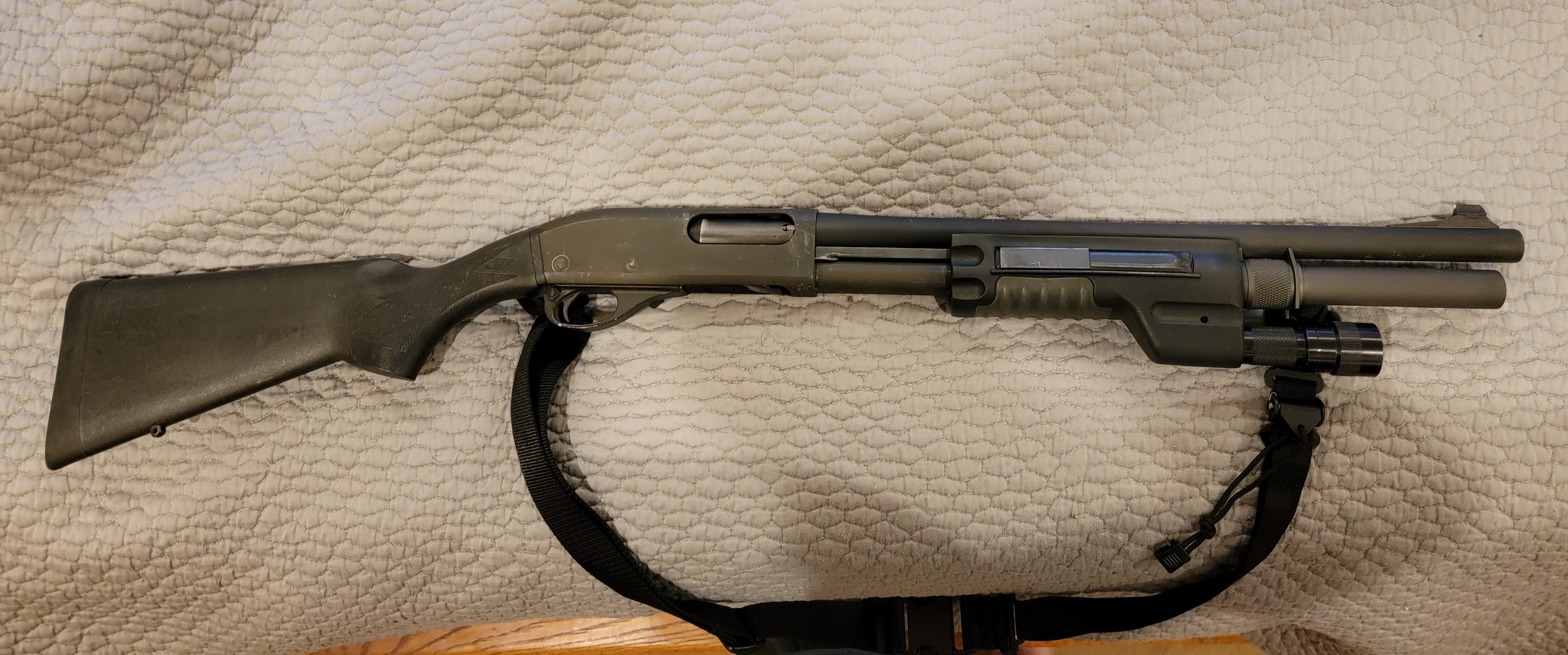

Another step forward with the boy-build...thanks to all you guys!
If there is any interest in the Surefire forend light, I'll have one once the wood is in place. Works great and is blinding! I've got three of them, one will be for sale. Surefire rulez!
Newly added Wilson +2 mag extention.  Added during a REALLY boring teleconference within 30 mins of receipt.  This is my twin 870P project, and this will go to my 18 year old son.  Wood furniture on it's way along with some trigger group pins.  When all together, we'll strip it down and ceracote.  If he wants.  I'm betting he won't let me touch it. He loves the "character".  I'm the opposite.  I want "brand new" and tactical.
