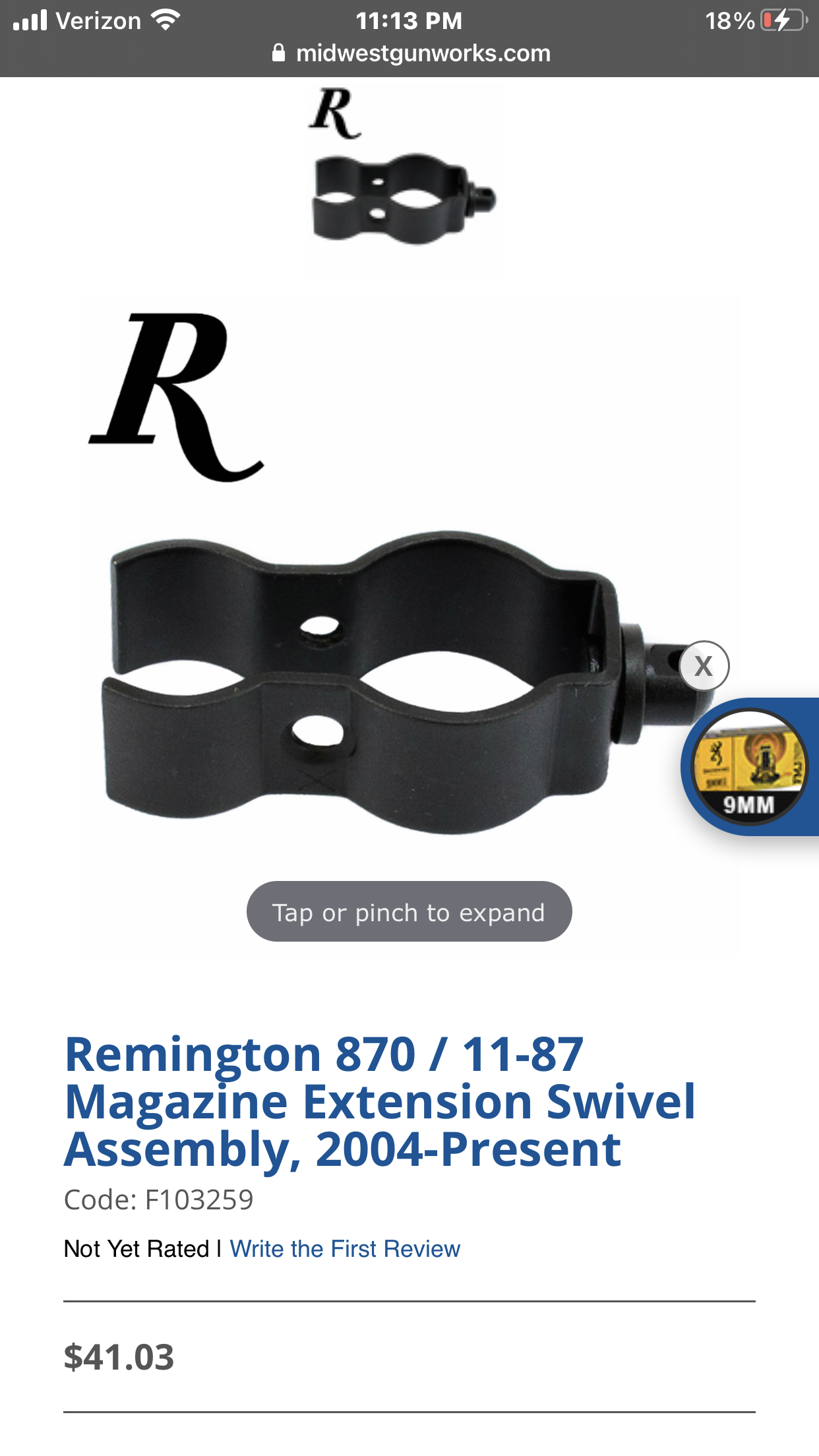

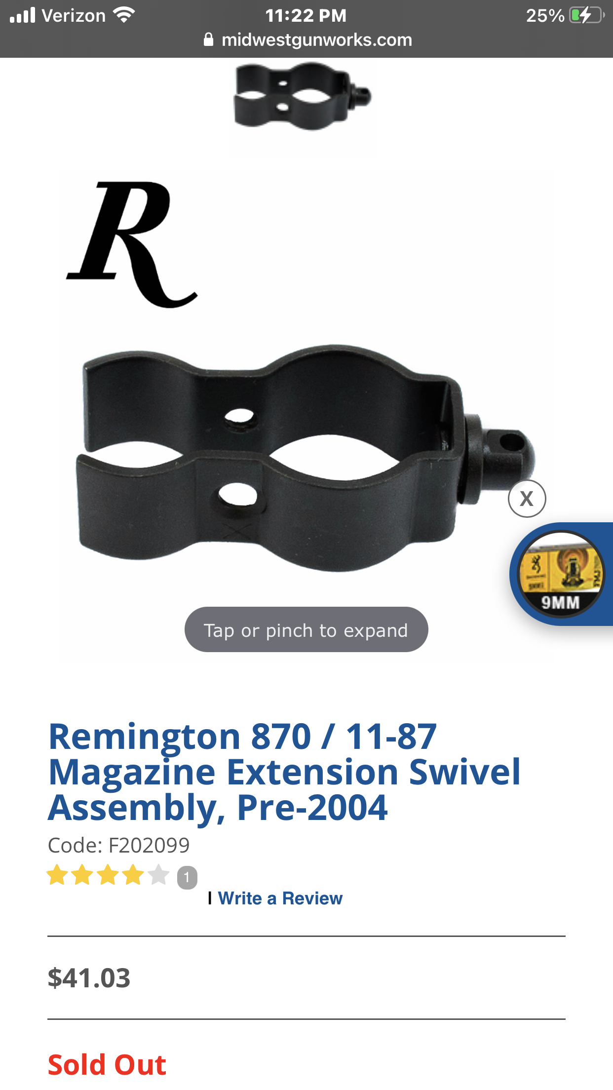

ChillyB wrote: Sat Dec 19, 2020 5:07 pm What is the significance of the X?
Different spacing between the barrel and magazine tube
ChillyB
Posts: 178
Re: 12ga Mag Tube sling under bracket
Post by ChillyB »
Huh. Since that dimension has never changed on the shotguns shall I assume one is correct and other is defective? Which one is correct?
Banshee
Posts: 399
Post by Banshee »
I don’t know why, but i do know all 870 barrel support rings are not the same hight. I first noticed it when a started making front sling mounts, some guns the mount would be loose and rattle and on others it would be tight . I first thought it was due to barrel diameter , but after measuring a dozen or so barrels i found there are two different center lines. The receivers are all the same dimension and only the front ring are different. Some barrels center lines do not run parallel with the center line of the magazine tubes. It may be the way Remington moved the point of impact on shorter barrels. I have some pictures here somewhere that clearly shows the different rings hight.
So they are both correct depending the barrel you have.

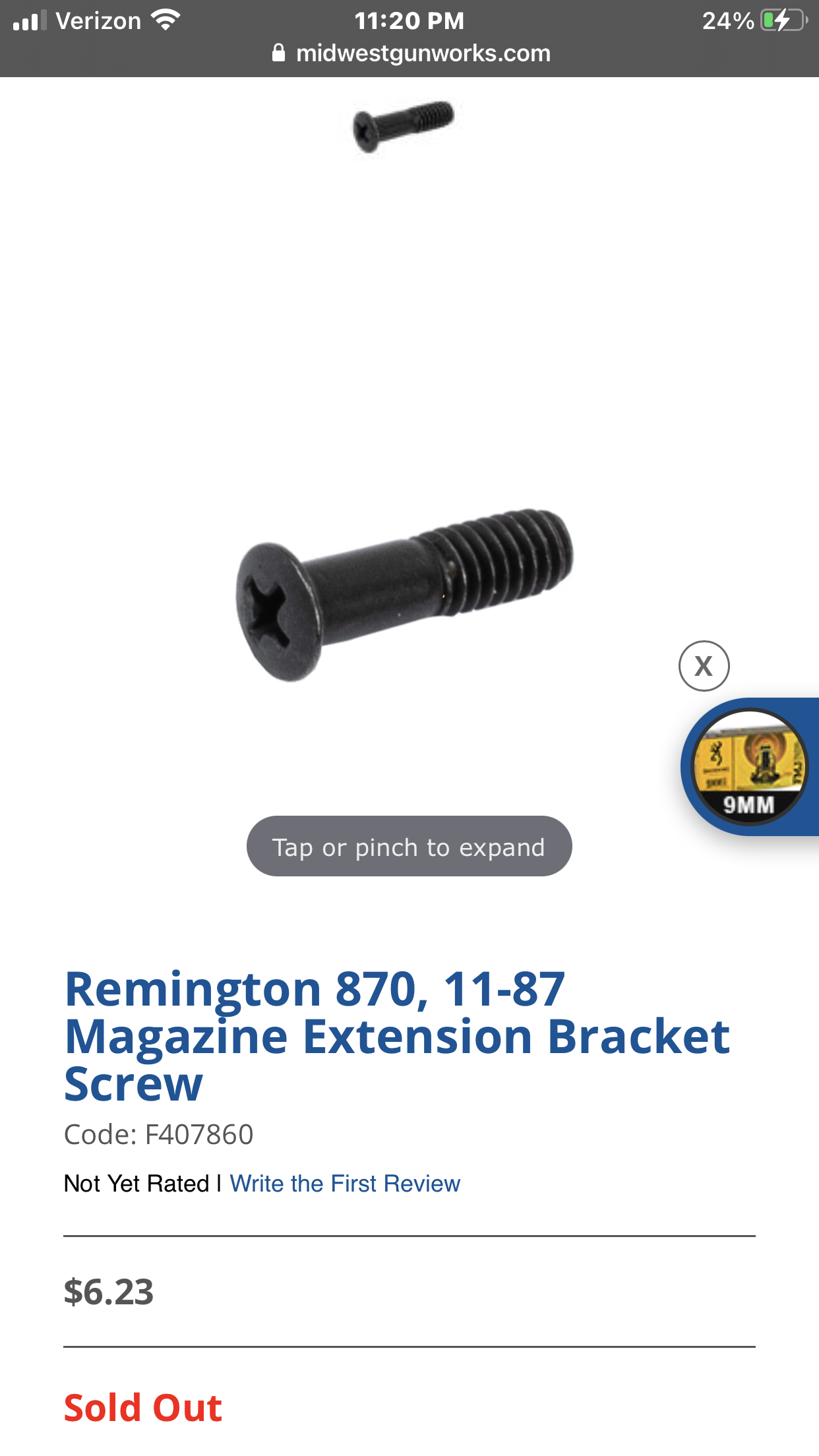

After still more research and hunting, I’ve discovered there is indeed two versions of the same bracket.
There’s a 2004 to present bracket and there’s a Pre-2004 bracket.
The part that really kills me though is the $41.00 price and another $6.23 for the screw ! I didn’t find the nut, but I’m sure it’s just as bad.
