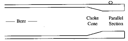

Nice work! So if a barrel is lets say a fixed full choke does that mean only the end of the barrel has restriction and not the entire barrel. For example if you had two fixed choked Remington barrels and one was cylinder and the other was full choke the only difference would be the last 3-4 inches of the barrel which is where the fixed constriction is?

Far as I know, it's just toward the muzzle, though that is a question I don't recall ever being asked before. I don't have any specialized tools that would read measurements way down in a barrel to say for sure, but the choke usually does refer to the diameter of the muzzle. And cutting a barrel shorter always has turned it into an open choke barrel.
In this case, it was a cylinder/open choke, and I had to ream out for the screw in choke. Which reduces the diameter at the muzzle. And most other factory barrel with thread-in choke are also fairly large in the main bore and only constrict at the choke. That's why it's shooting birdshot so much better now.

I found this on line, pretty good article.
https://www.gun-tests.com/special_repo ... 3zskxFx9A
John A.
Posts: 152
Re: Thinking of threading my 20" 870 barrel
Post by John A. »
Nice article. I suppose that answered your question.
